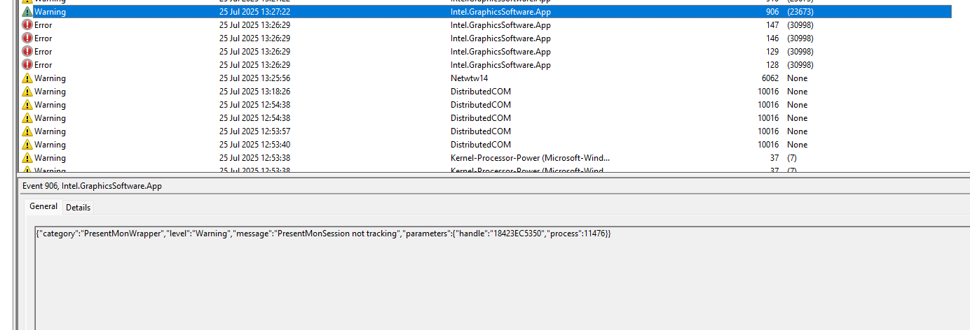

Dear all,
I've just updated the Intel Display driver to version 32.0.101.6972, and there is an error message in the event viewer like these from Intel.Graphics.Software.App :
{"category":"Igcl","level":"Error","message":"3rd Party - IGCL ctlEnumLeds - Exception","parameters":{"result":1073741834}}
{"category":"Igcl","level":"Error","message":"ctlEnumLeds, result=1073741834"}
Kindly advise how to fix it?
Thank you

Im having the same issues , havent been able to run any games without massive frame rate issues and other sorts of problems detailed below.
LT7879
40,013 Views
Hi
This is the link https://www.intel.com/content/www/us/en/download/785597/intel-arc-iris-xe-graphics-windows.html
I have uninstalled the IntelGraphicsApp and reinstalled it , uninstalled, and I try to download it from Microsoft Store. But the error remains.
Please find attached the errors screenshot and the SSU file.

LT7879
39,380 Views
Dear Archie,
1. yes I downloaded it from that link and also from the installer at the intel website. Both produce same error messages.
2. Have done it several time and I also did full clean install using Windows Media Creation Tools.
3. Done
4. Yes, when I opened the Intel Graphics Software
5. When I use the 32.0.101.6972, my system is not stable, especially when I do zoom meeting. It will crash with error event 141
Description
A problem with your hardware caused Windows to stop working correctly.
Problem signature
Problem Event Name: LiveKernelEvent
Code: 141
Parameter 1: ffffa486348ad060
Parameter 2: fffff8074fe229d0
Parameter 3: 0
Parameter 4: ffffa486533f2080
OS version: 10_0_26100
Service Pack: 0_0
Product: 256_1
OS Version: 10.0.26100.2.0.0.256.48
Locale ID: 14345
6.  Yes I am using Graphics driver from HP Support website version now, and for the Intel Graphics Software I am using the one from the MS. Store apps link you provided, and so far, no more crash or error message in the event viewer or reliability history report.

LT7879
39,141 Views
Hi @JeanetteC_Intel
This morning, those error message re-appear again.
Please advise what to do.
I also noticed 2 services from Intel is not running:
- Intel Graphics Display Graphics Services
- Intel Platform License Manager Service
Please advise: if it is not being used, can those services be removed? If it is being used, how can it be fixed?
I attached the error messages and also the Intel Graphics Software version and services

NormanS_Intel
38,506 Views
Hello LT7879,
I want to let you know that we have successfully replicated the issue you reported and are actively investigating its root cause. Please be assured that we are looking into this matter and will provide an update as soon as we have more information.
Norman S.

Hello LT7879,
I hope this message finds you well. I wanted to inform you that the issue you reported is no longer observed with the latest driver version 101.8425. Please update to this driver version to benefit from the fix.
If you encounter any further issues or have questions, feel free to reach out.
