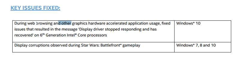

I got a new Asus Windows 10 64-bit laptop that has both Intel HD graphics 530 and nVidia GeForce GTX 960m dedicated graphics. When browsing the web, especially while using Google Images, my computer freezes up for a second, unfreezes, and I get a notifcation saying the Intel HD graphics driver crashed and recovered itself. This happens multiple times per day and there are no driver updates yet from the Asus website as this is a new model of laptop.
I've also had a couple of blue screens due to "VIDEO_SCHEDULER_INTERNAL_ERROR" that I believe is related, as it freezes up while browsing the web much like the driver crashes, but then it goes to a black screen for a couple of seconds and then the blue screen.

I have driver version 10.18.15.4268 dated to 2015-08-05.
Unlike the other post, I am not getting screen flickering. The screen simply freezes for a second and then resumes as normal, and I get a notification that the Intel HD graphics driver stopped responding and recovered itself. This only happens when browsing the web regardless of the browser I'm using.

Please try with the following driver version https://downloadcenter.intel.com/download/25541/Intel-Beta-Graphics-Driver-for-Windows-7-8-1-10-15-40- Download Intel® Beta Graphics Driver for Windows® 7/8.1/10* [15.40], where this issue is stated as fixed, note the picture below;
For further reference https://downloadmirror.intel.com/25541/eng/ReleaseNotes_GFX_15%2040%204326_Final.pdf https://downloadmirror.intel.com/25541/eng/ReleaseNotes_GFX_15%2040%204326_Final.pdf

Unfortunately I am unable to install that driver as I get an error telling me that it's not for my computer and to visit the manufacturer's website in order to download the correct driver. I am already running the latest driver available on the manufacturer's website.

By the way, steph_444444, you can click in device manager, under intel 530, click update driver, do it manually, choose from a list, and pick the Microsoft basic display adater and that will temporarily and dirtily fix the problem. but this is not the right solution.

https://downloadcenter.intel.com/download/25620/Intel-Graphics-Driver-for-Windows-7-8-1-10-15-40-6th-Gen- Download Intel® Graphics Driver for Windows® 7/8.1/10* [15.40 6th Gen]
This is better.

ok so this driver worked for me. and i dont have the problem anymore.
not sure if this matters, but i had switched my intel display adapter driver to a microsoft basic display adapter before.
then the install given by yups worked, and the intel reappeared in the device manager and no more display driver instability for now.
thanks. hope this works for you guys too.

i went to device manager
under display adapter, right click properties on the intel hd 530
went to driver tab
clicked update driver button
chose to browse my computer for driver software
then chose to pick from a list of device drivers on my computer
then i had the choice between intel hd 530 and microsoft basic display adapter
i was using it until i updated to the driver 15.40, i thought i would have an error saying it should be provided by the manufacturer but no the driver installed and it seems stable.
hope this helps

Thanks so much! That did the trick.
