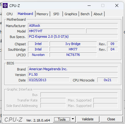

Hi, AIHILL
Thanks for the quick reply.
I haven't noticed any problems with Win11pro on the 5 mini PCs, despite their age. One PC has an Intel i7 CPU, see screenshot,
which I'll send later. Another screenshot shows the update history of the Intel drivers, everything is OK. The assumption that the graphics driver is the reason why memory integrity cannot be enabled is incorrect.
Yes, there is a saying in German, “Those who can read have a clear advantage.” I have found out why memory integrity cannot be enabled and just need to try it out.
https://support.microsoft.com/de-de/windows/ger%C3%A4tesicherheit-in-der-windows-sicherheit-app-afa11526-de57-b1c5-599f-3a4c6a61c5e2#bkmk_coreisolation
Note: To use memory integrity, hardware virtualization must be enabled in your system's UEFI or BIOS.
I didn't know that before. If you're interested, I'd be happy to tell you more about it.
If not, we can close this post.
Best regards, Klaus
Translated with DeepL.com (free version)

Hi, AIHILL
Best regards, Klaus
Klaus-H
5,168 Views
