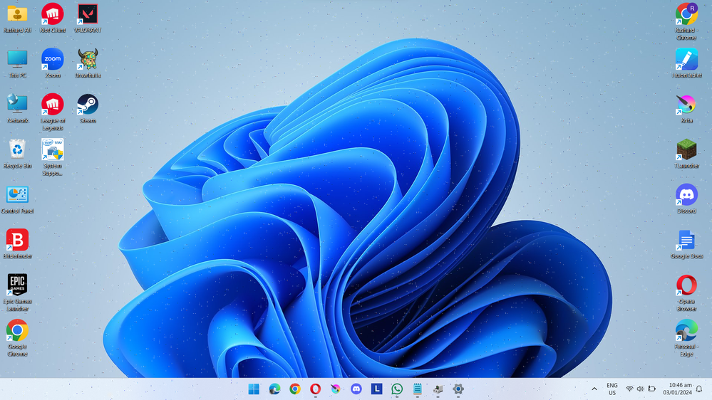

My laptop display shows multiple colored spots and occasional lines and I'm convinced it is the graphics driver because when I switch the display adapter to the Microsoft basic display it fixes it but can't play games or adjust brightness .
My processor is 12th Gen Intel(R) Core(TM) i5-1235U 1.30 GHz and I have the Intel(R) UHD Graphics Version 31.0.101.4502 and and installed version 31.0.101.5082 but nothing helps

I bought the laptop brand new and have had it for around 9 months .
It was working perfectly before and it started on 12-31-2023.
No hardware or software changes were made that would cause this problem.
The problem is consistent except when playing video form media

Here is what the display looks like without any screen interactionHere is what the display looks like without any screen interactionHere is a screenshot of what happens when in game, lines often move aroundHere is a screenshot of what happens when in game, lines often move around
The issue is not visible on the BIOS screen
This is the BIOS version information I could find LENOVO JKCN42WW, 06/09/2023
The issue is visible on external displays using the latest drivers

Hello trashpanda, I just received an update on this matter.
After reviewing the information you just provided, we do not consider this issue to be related to drivers for the following reasons:
 -We haven't received more cases about this issue from other users
-OEM driver which is older shows the same behavior as the latest drivers it seems no matter the version used it happens.
The reason why you do not have any issues with the MS display adapter is that the display without a driver won't use its full capabilities. To use its full capabilities, it is needed to install the driver and then is when the issue starts.
Considering the problem described, this could be hardware-related or maybe an Operating System corruption issue. Based on that, if it is possible, could you please try to either roll back the Operating system to a restore point of when it was working fine or reinstall Windows* for testing purposes?

trashpanda
10,475 Views
It is not possible to roll back the Operating system and re-installing windows unfortunately did not help.

trashpanda, Thank you very much for your response.
We are sorry to hear the problem persists after trying the troubleshooting steps suggested previously.
Based on those results, in that case, what we recommend as the next thing to do, will be to get in contact directly with the manufacturer (OEM) of the computer as soon as possible to report this situation. They did the integration of all the parts and this behavior could be related to the processor, HDD, memory RAM, or even the motherboard itself. The OEM supplies the warranty for all the components. They could reproduce the issue using the same exact machine you are working with, provide a fix for it, do a physical inspection of the computer if needed, suggest further troubleshooting steps or technical assistance, and ultimately to replace the laptop under their warranty policies:
