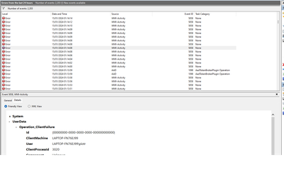

piotr-warsaw
2,923 Views
BTW, I noticed an interesting set of errors on my machine. Maybe that is helpful?
- <System>
  <Provider Name="Microsoft-Windows-WMI-Activity" Guid="{1418ef04-b0b4-4623-bf7e-d74ab47bbdaa}" />
  <EventID>5858</EventID>
  <Version>0</Version>
  <Level>2</Level>
  <Task>0</Task>
  <Opcode>0</Opcode>
  <Keywords>0x4000000000000000</Keywords>
  <TimeCreated SystemTime="2024-01-15T00:14:08.8865111Z" />
  <EventRecordID>1891503</EventRecordID>
  <Correlation ActivityID="{a41740b9-46e4-0008-2169-17a4e446da01}" />
  <Execution ProcessID="4396" ThreadID="30392" />
  <Channel>Microsoft-Windows-WMI-Activity/Operational</Channel>
  <Computer>LAPTOP-FN76EJ99</Computer>
  <Security UserID="S-1-5-18" />
  </System>
- <UserData>
- <Operation_ClientFailure xmlns="http://manifests.microsoft.com/win/2006/windows/WMI">
  <Id>{00000000-0000-0000-0000-000000000000}</Id>
  <ClientMachine>LAPTOP-FN76EJ99</ClientMachine>
  <User>LAPTOP-FN76EJ99\piotr</User>
  <ClientProcessId>3020</ClientProcessId>
  <Component>Unknown</Component>
  <Operation>Start IWbemServices::ExecMethod - ROOT\WMI : \\LAPTOP-FN76EJ99\ROOT\WMI:WmiMonitorDescriptorMethods.InstanceName="DISPLAY\\PRS0715\\5&20117d68&1&UID4625_0"::WmiGetMonitorRawEEdidV1Block</Operation>
  <ResultCode>0x80041001</ResultCode>
  <PossibleCause>Unknown</PossibleCause>
  </Operation_ClientFailure>
  </UserData>
  </Event>
