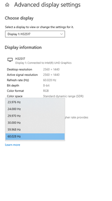

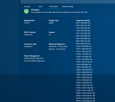

I have a Lenovo Thinkpad t14 Gen1 with an i5 10210u. I try to connect an external 2k 144hz monitor directly with an 2.0 HDMI cable. Windows wont display any refresh rate above 60hz on either 2K or 1080p resolution.
Also under the Intel Graphics Command Center the connector type is displaying the connection as Displayport instead of HDMI.
I unistalled the UHD drivers and re install the latest ones 31.0.101.2114.
The laptop's hdmi out is rated at 4k 24hz max so 2k 144hz shouldnt be an issue.
I have tested both the monitor and the cable with another Lenovo yoga laptop with UHD graphics and they work perfectly at 2k 144hz.

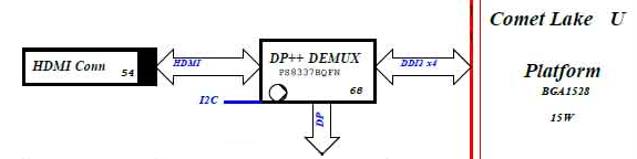

The HDMI port on this platform is connected internally via a DisplayPort source demultiplexer, which is why the driver shows "DisplayPort" as connector type.
This port corresponds to HDMI version 1.4. This basically enables Transition-Minimized Differential Signaling (TMDS) at up to 300 MHz. Unfortunately, that's not even enough for 1080p @ 120 Hz. According to the associated HDMI specification, a refresh rate higher than 60 Hz is not provided anyway.
Your monitor appears to be the KTC H32S17. I would recommend to connect the laptop via an USB-C > DisplayPort cable. You can plug such a cable to either the USB-C port [1] or the Thunderbolt port [3].
