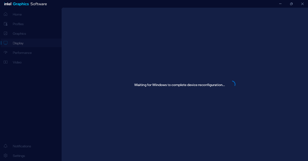

I'm experiencing an issue/bug where the Display tab keeps reconfiguring indefinetely, causing all the other tabs to grey out. I just updated the graphics driver and controller today (23/08) indicated in the title; the only fix for this issue is a rollback.

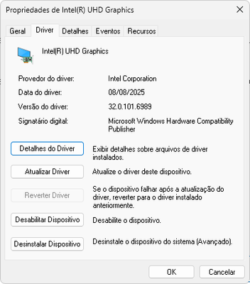

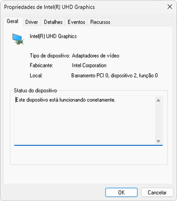

Guicrz-insp_35
4,824 Views
Sure:
Guicrzinsp_35_0-1756217513661.pngGuicrzinsp_35_0-1756217513661.pngGuicrzinsp_35_1-1756217577469.pngGuicrzinsp_35_1-1756217577469.png
Now both status and details are in a different language, so probably you might not get it;
Plus, answering your question, I initiated manually.

Guicrz-insp_35
4,554 Views
Still the same:
