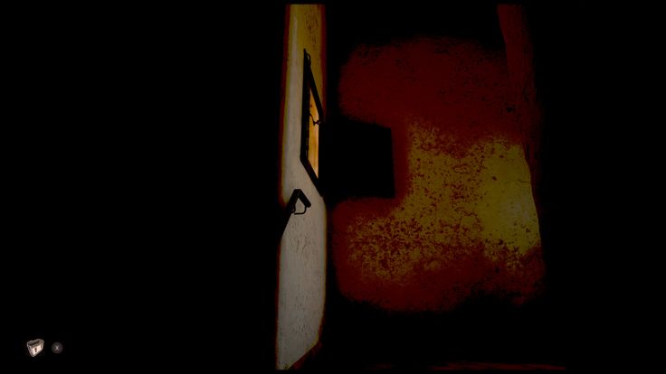

I reinstalled the A770 16GB drivers (the latest ones) with a clean installation and also reinstalled the game, but to no avail. The DX11 version is okay, but the lack of XeSS and the performance, which is some kind of stutter fest, makes me prefer DX12 -as usual, whether a game runs fine or not, I prefer DX12 over DX11-.
Oddly enough, the game ran well before in DX 12 mode with XeSS enabled and so on. It had some graphics issues, like some kind of black magenta crush, which made the game almost unplayable in some areas, but the performance was better than in DX11 and XeSS does a good job in this game. Not at the almost perfection level of Shadow of the Tomb Raider, but okay.
The "black magenta" crush when the game worked in DX12 mode. I took these pictures days ago.
