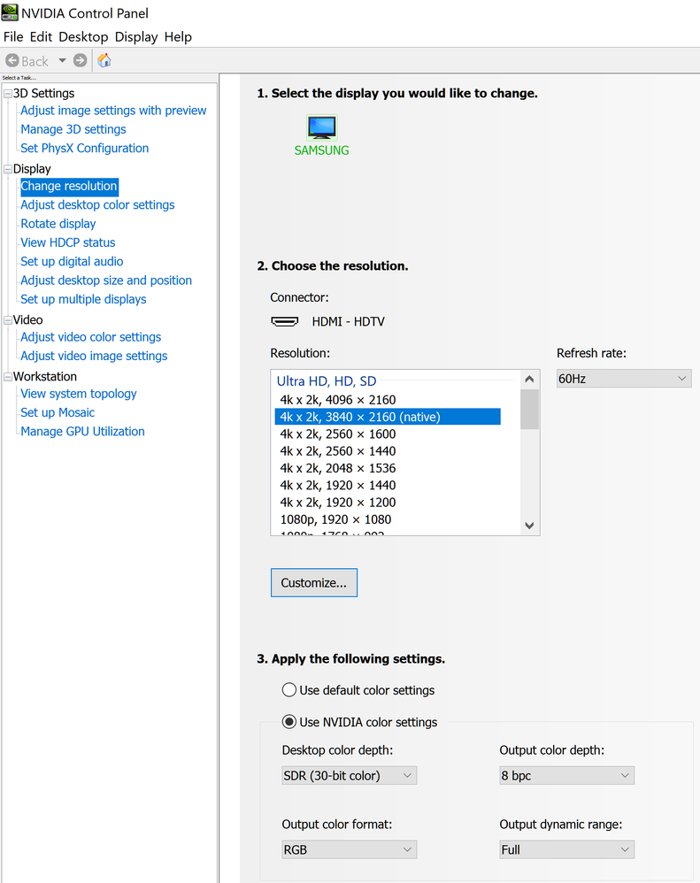

Using my 4K Samsung smart TV and Windows 11, unable to set RGB more than 30Hz @
3840 x 2160 VIA HDMI.
Why is that?
I can only get 60Hz @3840 x 2160 when selecting YCbCr 4:2:0 color space. This setting will usually makes standard text look fuzzy and reduces its clarity.
NOTE: I did a clean install of the latest graphics driver but the issue still exists.

Have you tried using the Intel PC with the same cable as the Nivdia PC?
Yes that looks good. Then we can exclude the cable.
4K @ 60Hz RGB 8-bit = 18 Gbps TMDS
The N5105 should be able to do that too. This is a Jasper Lake platform.

Unfortunately I had to go back and use my old bulky HTPC that has a dedicated Nvidia Quadro P400 graphics card that works with the
HDMI UHD Color = ON option.
Using any computer with Intel integrated graphics (I have tried a few different CPUs and drivers) will result in "No Signal" on my Samsung TV, when the option selected is "HDMI UHD color = ON".
