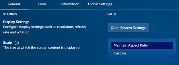

In earlier versions of the Intel Graphics Command Center (IGCC), there were certain scaling options available. However, this has been addressed by introducing the "Custom" Scaling option, as demonstrated in the following article:
Scale Options Are No Longer Available After Updating the Intel® Graphics Command Center
Moreover, within your current IGCC version, you might find two available options: 'Maintain Display Scaling' and 'Custom'. In the event that these options aren't visible, I recommend referring to this article for further insights:
Custom Scaling Option in Intel Graphics Command Center (IGCC) is Missing
Check the attached picture.
Isaac Q.
There's no "DISPLAY scaling" there's only "ASPECT ratio" i also bought notebook yesterday and there's only aspect ratio aswell as on my PC, no DISPLAY scaling...
And the screenshot you provided also shows it has ASPECT ratio and not DISPLAY... srsly?

We sincerely regret any confusion that may have arisen. Your observation is accurate and aligns with the available options. To address this, I am committed to conducting an in-depth investigation. This entails researching potential solutions, as well as determining the accuracy of our existing articles. It is plausible that certain articles may have become outdated, contributing to the situation. I am committed to verifying this aspect as well.

But what about screenshot that you provided in your first massage? Isn't that the same problem? How did you not find the problem if it is on your screenshot?🤣
By the way it shows Maintain Display Scaling in the control panel now (not in the beta)...
But i'm not sure the image on the monitor look as it should be with "display scaling", because i have NVIDIA card and this monitor looking different there.
