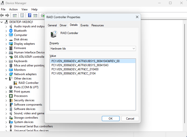

Just bought a new PC and Installed a fresh new windows 11, can't find the brightness slider bar, so I check the Device Manager and this is what I saw.
My CPU is Intel Core i7 12700KF with ASUS Z690 mother-board, The IDs are:

RAID Controller
PCI\VEN_8086&DEV_467F&SUBSYS_86941043&REV_00
PCI\VEN_8086&DEV_467F&CC_010400

When I click Update Driver and Search Automatically For Driver Update this is what I saw:
I can't update it any further. After skimming through the forum I've found similar topics but not specifics enough to fix my problems. Most of them say that I need to install the intel driver chipsets but I don't know where or which one I should install. Can someone give me the links to the correct version, I'd be appreciated, been spending the past 5 days trying to fix this **bleep** PC.

The downloads page for your motherboard is here: https://www.asus.com/motherboards-components/motherboards/prime/prime-z690-p-wifi-d4/helpdesk_download/. Select Windows 11, 64-Bit first, then click on the Show All link for the Chipset section (it is just below the entry displayed initially). Download and install the packages titled:
- Intel Serial IO driver
- Intel GNA driver
- Intel consumer ME driver
- Intel chipset driver
The last is the most important for the resolution of the chipset devices.
Hope this helps,

No, not using Device Manager. All four packages offer executables, AsusSetup.exe, that you need to run.
Ok, I can't seem to install the Intel GNA driver, when I execute that one, a black cmd window popped up and disappear, nothing happen. After I restart, all the devices are gone except one left, the RAID Controller:

The RAID controller entry is for the Intel VMD controller. There is a package for this on the Asus site under the SATA category named Intel Rapid Storage Technology Driver software V19.5.1.1040 For Windows 10/11 64-bit. I made that a link so that you can download it directly.

Oh sorry to hear that, I hope you recover soon, thank you so much for your help, it's all fixed now.
