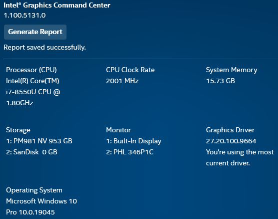

I have a Dell XPS 9360, i7-8550U 8th gen, Intel UHD 620 graphics, Win10 22H2 19045.3208. The graphics driver is Intel 27.20.100.9664 (01/06/23 ... either 01-Jun or 06-Jan)
The machine runs:
- Built in laptop touch-screen 3200x1800
- External Philips 346P1C 3440x1400
- External Dell P2717H 1930x1080
The Philips acts as the base station and so laptop to Philips is USB-C, then Philips to Dell screen via daisy-chained DP.
I use this setup with the Dell XPS and also an HP Elitebook 840 G8 (i7-1165G7 11th gen). I swap the two laptops depending no what I'm working on. Both machines have worked flawlessly with supporting their own display + both external monitors in full native resolution without issue.
Today, however, swapping back to the Dell XPS, the Philips 3440x1440 is having problems and the display is blurred. Please note my comment about previously being flawless with crisp text as full native resolution.
The display adapter is now listing modes up to but not beyond 2560x1080 50Hz which gives a 'less bad', but over-scaled image and text.
Using the Intel Graphics Command Centre it confirms the display supports (among other lower res modes)
- 2560x1080 50, 60 or 100p Hz
- 2880x480 60p Hz
- 3440x1440 60p Hz
If I select to 'Merge all displays into one desktop', the merge fails with an "Invalid Monitor Configuration", but the resolution for the Philips is set to 3440x1440. I ought to be happy, but despite now saying the adapter is set for the screen native resolution, everything is blurred. It's as if it's an upscaled image, only with the adapter and monitor native resolution matching??
I have tried roll-backs of Windows updates, rollback and also check for the latest Intel driver, all to no avail.
I am at a loss as all was good before, but today I can only have a blurred main display, and please remember, this all worked flawlessly before so it's not a case of "This can never work". This has been working only a few days ago.
The screen and USB-C are confirmed as being fine as they are perfect with the Elitebook. That of course is using a beefier cpu and an Intel Iris Xe GPU, but when the XPS was used maybe a week ago and for a long time before that, all was perfect, no blurred image and text.
Any ideas on what to look at/try next?

Also please send us the following:
- IGCC REPORT: Follow these steps to generate an Intel® Graphics Driver report for the Intel® Graphics Control Panel or the Intel® Graphics Command Center. Report for Intel® Graphics Drivers.
- SSU: Please download and scan your system using our tool, Intel® System Support Utility so we can help check your system info first. Once finished downloading, open the tool, click on scan 'Everything', click next, then save the system information to a .txt file. Please provide the .txt file.
- Screenshots of the Device manager. We need to check if there are some issues with the display adapters.

- IGCC System Diagnostic report and screenshot attached
- ISSU report attached

Update...
I have not yet tried the clean re-install of the graphics driver, but I did run another revealing test.
We have another 'identical' XPS 9360. It is also Win10 22H2, and excepting a 500G v 1T SSD, is the same. It is also running the v27.20.100.9664 video driver.
Plugging this second 9360 into the Philips, everything worked correctly. All 3 panels working at native resolution. No issues, nothing to change, just plug in the single USB-C and everything working.
This shows the panels, the integral base station within the Philips etc. are all working okay, it is something about this specific 'problem' XPS 9360.
The second 9360 has now been taken away again and so the 'problem machine' is back connected to the 2 external monitor setup. In plugging back in, the 3440 x 1440 panel reverted to the upscaled display issue, BUT, on checking the Windows Display panel and the Advanced display settings for the Philips panel, now, instead of only a 50Hz refresh being offered, 50, 59.something and 59.982Hz were offered. Previously there was only one option, 50Hz.
Selecting 59.982, being the closest to 60Hz being offered, the resolution is suddenly perfect. More interestingly, the offered refresh rates are now only 48.000 or 59.982. 50Hz and 59.something are no longer there, just 48.000 and 59.982, and the only change was to select 59.982 rather than 50.
I was down to looking at Windows update patches applied to each machine, which are not quite the same, looking for what could be different, but I now have 'the problem machine' working again, but with no explanation or understanding as to why.
As mentioned, a week ago this 'problem XPS' was working fine. Then mid-last week it started to have this upscaled image issue on the 3440 x 1440 main display. Then trying the second XPS proved the panel setup was not the issue and all working correctly. Then, on plugging the 'problem XPS' back in , there is suddenly an option to set a refresh rate other than 50Hz. Previosly this was the only option being offered. But on selecting a refresh rate close to 60Hz, all is instantly good.
It's 'wonderful' it's working properly, but less wonderful that I have no explanation of why it had this issue or how it has been corrected.
