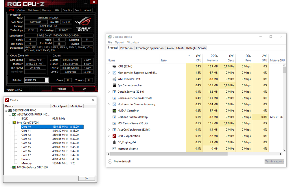

In December I added another 16 G (8x2) of ram (HyperX Fury) which I fooled around to take them from 2666 MHz thinking that there would be no problems also because the motherboard as a frequency reaches a maximum of 2666 MHz for RAM. And I changed the cooler with a liquid one, the Corsair iCUE H100i ELITE CAPELLIX. I also moved the GPU one slot lower for convenience. I turned on and everything worked, I found a softwere for the ram and I set all the RGB. From the next day I started to notice this problem: a "rest" the CPU has a frequency of 4.5 GHz while if I start a game or heavy programs the frequency of all the CPU cores drops to 0.8 GHz and consequently slowing down the processes a lot. Before having these problems I had never touched the BIOS except to increase the RAM frequency. The strange thing is that if I change any BIOS setting (for example I put the RAM frequency from 2666 MHZ to 2600) I start the PC and everything works correctly then I turn off the PC and turn off the power and once turned on problem. I tried to remove the HyperX RAM and leave the privateer that could be the problem but it isn't. I have no idea what the problem may be as I have never even tried to overclock the processor.
I am attaching a photo with the pc without heavy processes and one with. I really hope you can help me because I have been scrambling to try to figure out what the problem may be and I can't give me an answer, Thanks in advance.Screenshot (340).pngScreenshot (341).png

Sebastian_M_Intel
16,886 Views
Hello Gio,
Please provide the outcome of the following::
  • 1. Run the Intel® System Support Utility (Intel® SSU) and attach the report generated:
  • Open the application, check the "Everything" box, and click on "Scan" to see the system and device information. By default, Intel® SSU will take you to the "Summary View".
  • Click on the menu where it says "Summary" to change to "Detailed View".
  • To save your scan, click on "Next", then "Save".
  • Use the option under the reply window to attach the report to the thread (Drag and drop here or browse files to attach).
2. Run the Intel® Processor Diagnostic Tool and send the results either in a screenshot or .txt file. To save the report, once the test is done, click on "File >> View Results File" and attach the .txt file to your reply. 
3. Run the Intel® Extreme Tuning Utility (Intel® XTU) and send us a screenshot of the frequencies and temperatures while running this tool.
4. Remove the new RAM sticks that were recently added, is the issue still occurring?
  • If yes, load BIOS defaults, add the new RAM, and remove the Corsair. Check with Asus* for help on this.
  • If not, then the issue is with the new RAM sticks you added.
5. As a general recommendation, according to the motherboard manufacturer's manual, the video card should be installed only on the top PCI-E slot to get maximum bandwidth when using a single GPU, check that here on page 1-8: https://dlcdnets.asus.com/pub/ASUS/mb/LGA1151/ROG_STRIX_B365-G_GAMING/E15361_ROG_STRIX_B365-G_GAMING_UM_WEB.pdf

4. I have already removed the new rams but the problem persists. Later I will try to do as you say.
5. Yes, I know. I understood my mistake and moved it to the upper PCI-E slot.
P.S. Thanks for your help.

Ok, it's possible that i have the solution. When i upgrade the pc it run well, but i want to have the rgb of the ram synchronized with the others. So I use Armoury Crate and fot the occasion i instal some new driver. Then i turn off the pc and the day later the problems start. I think that this driver is the problem.
I haven't uninstalled them yet, I'm waiting for your response to know what you think.
Goodbye, Gio.

In this case, I believe it's worth a try to revert the changes made before the issue started. You may uninstall those drivers and installing the latest updates provided by Asus.

Ok, now the PC run well. In these days I will see if it still gives me problems, I will not finish the discussion yet in case you go back to having problems but if I have nothing to report during the next week I will finish it. Thanks fo all, Gio.

Thank you very much, these days the pc has not given me any problems so I can say that it was a driver downloaded from Armory Crate that was giving problems. I would consider the discussion over, thank you very much for your support if I still have problems I will contact you. Goodbye, Gio.
