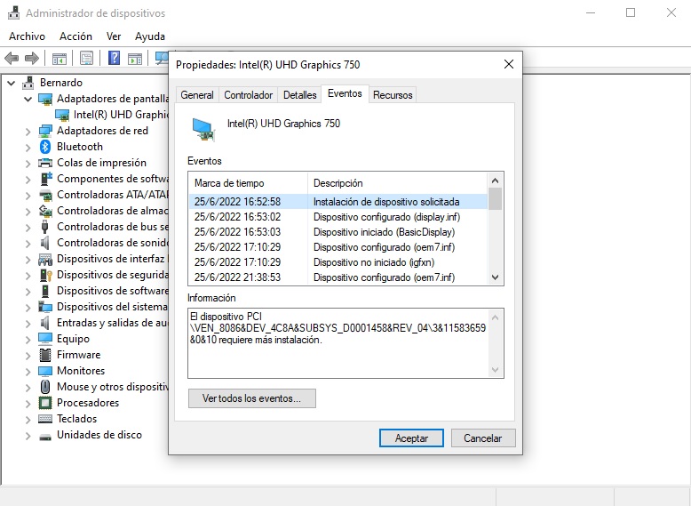

  Hola, buenas noches.
  Les escribo porque estoy teniendo problemas con los drivers de video, de una tarjeta gráfica UHD 750 y un Microprocesador Intel Core I7-11700k.
  El problema, es que los drivers no me otorgan una resolución de 1920x1080. Compré un monitor 27" y al conectarlo, se queda en negro, solicitando que se cambie la resolución a 1920x1080. Intenté con otro monitor, 22" de 1920x1080 Full Hd, me dió video pero se veía mal.
  Mi monitor de 27" lo enchufé a otra computadora y funciona perfecto, por lo tanto no es el monitor.
  Hice un formateo del equipo, le instalé el .INF y no sirve de nada, al bajar y actualizar el driver, me deja sin video.
  Ojalá puedan ayudarme.
  Gracias

The computer is about 4 months old. I bought it and put it together on my own, I've been using it perfectly since February. I'm currently using a borrowed 22" DELL monitor. I managed to buy a 27" monitor but when I plug it in, it leaves me with a black screen with a banner asking to change the resolution to 1920x1080, but that should be done by the system itself. A colleague lent me a 22" monitor with a 1920x1080 FULL HD resolution, I can see an image but the images are not clear. The connection method I am using is through the DisplayPort port, it is the only video port that comes with the motherboard I have.
The 27" Philips monitor, I connected it to another computer and it works perfectly, via HDMI.
One job I did was reinstall the operating system from scratch, connecting the 27" monitor. I was able to install Windows 10, but with a resolution of 1027x768. When I install the video card drivers, it automatically leaves me without a screen, with which, I have to unplug it and plug in the 22" monitor (1680x1050 resolution) and it looks perfect.
Regarding the DisplayPort cable, I bought 3 different ones, and with all 3 I have the same problem.

According to the SSU report, the graphics driver currently installed on your computer is version 30.0.101.1273.
It is important to mention that we always recommend to install the graphics driver provided by the manufacturer of the computer, since that driver was customized by them to work with your specific platform.
I looked on Gigabyte's website and the latest graphics driver they have available is version 27.20.100.9805. Please try a clean installation of that driver following the instructions in the links below:
https://www.gigabyte.com/Motherboard/Z590-AORUS-ULTRA-rev-10/support#support-dl-driver-vga
If the problem remains after that, even though the Intel® graphics drivers are generic, we can try a clean this time of the latest Intel® graphics driver version 30.0.101.1994:
https://www.intel.com/content/www/us/en/download/19344/intel-graphics-windows-dch-drivers.html?
Additionally, we also recommend to get in contact directly with Gigabyte Support to verify that the latest BIOS version is currently installed on your computer or, if necessary, to gather the instructions on how to update it:

Unfortunately, I did everything that they told me, but the problem was not solved. Uninstall the drivers and leave the native Windows ones, and when installing the new ones, it leaves me with no image, with the same sign that says that I must change to a 1920x1080 resolution. I did it 3 times, all 3 times it did the same thing to me. I've tried 2 different operating systems and it doesn't work on either.
I'm going to try to contact Gigabyte to help me with the Bios update, since it's through a flash drive.
