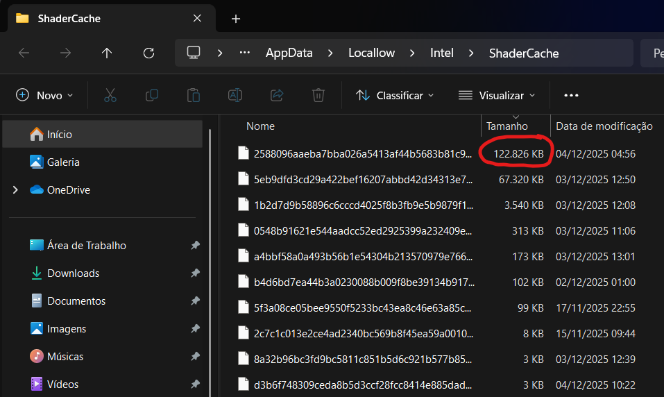

Hello! My Arc B570 graphics card has constant crashing problems in several older games, especially those that use DirectX 9.
One solution I found is to manually clear the ShaderCache folder, as files that typically exceed 150MB cause the game to crash or simply not open.
A solution would be to empty this folder during gameplay or simply not allow files larger than 100MB to be created in this folder.
This solution will probably work, as the B570 and B580 cards are powerful and fast enough to constantly generate new files without losing any performance and don't need this type of ShaderCache for older games.

I don't use any program to check the size, I just go to the folder C:\...AppData\Locallow\Intel\ShaderCache and check the size of the created shader file. Any file between 100mb and 150mb causes the game to crash at any time without any error message. The game doesn't show any performance loss with low FPS or anything like that, everything works normally until it simply crashes.

I updated my Windows and now it displays an error message when the game crashes. I monitor the shadercache file directly in the folder and as soon as it exceeds 200MB (but it can happen sooner), it displays the error message "ERRO8: Out of video memory".
My PC has 16GB of RAM (DDR4 8GB + 8GB) and the Intel Arc has 10GB, obviously there's plenty of memory left, but some parameter used in DirectX 9 must not allow creating cache files larger than 200MB.
Screenshots of the errors and settings are attached.

I'd like to thank you for identifying the workaround (clearing Intel cache)
Hi Intel @Zach_Intel
Adding to Yano report:
I'm also having issues with old games, specifically Resident Evil 6
  • Device: MSI Claw EX AI+, Intel Arc B390 GPU
  • Driver: 32.0.101.886
Issue:
  • The game first starts and plays with no issue
  • After a few sessions, loading any mission will result in a crash
  • (Session: play and then quit game, turn off device)
Steps taken:
  • Performed a clean re-install of the driver
  • The game was playable right after the driver reinstall
  • However, after playing for a few sessions, the crash returned, the game crash when loading into a mission
  • This time, thanks to Yano17, I just deleted the files in intel cache folder and the game stopped crashing.
