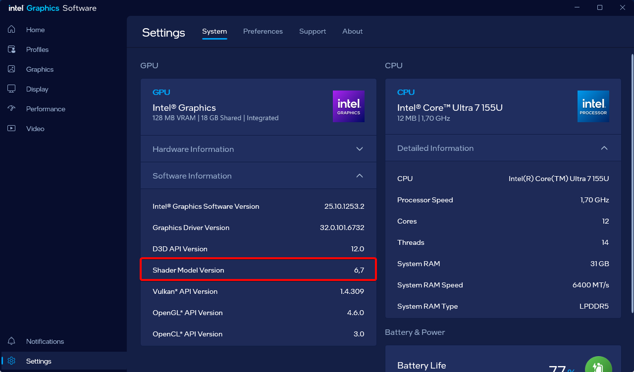

I am running on Intel graphics on the CPU Intel® Core™ Ultra 7 Prozessor 155U with the newest driver (Intel® Graphics Driver 32.0.101.6732).
The Intel Graphics Software tells me, my current graphics unit and driver support the shader model 6.7. (see attachment)
However, when I start any game that relies on the Unreal Engine 5, I get an error message reporting my machine does not include necessary features like DirectX 12 and shader model 6.6. (see attachment)
On further investigation, the dxcapsviewer (DirectX Capabilities Viewer utility) shows a shader model support of 6.5. (see attachment)
So clearly, something does not add up here. Is the supported shader model perhaps incorrectly reported by the graphics unit or driver? Or is there something else that is actually not supported by the intel integrated graphics?

Apologies for such a delayed response on this issue. This issue is resolved in the latest version of Intel Graphics Software.
Thanks for your patience!
