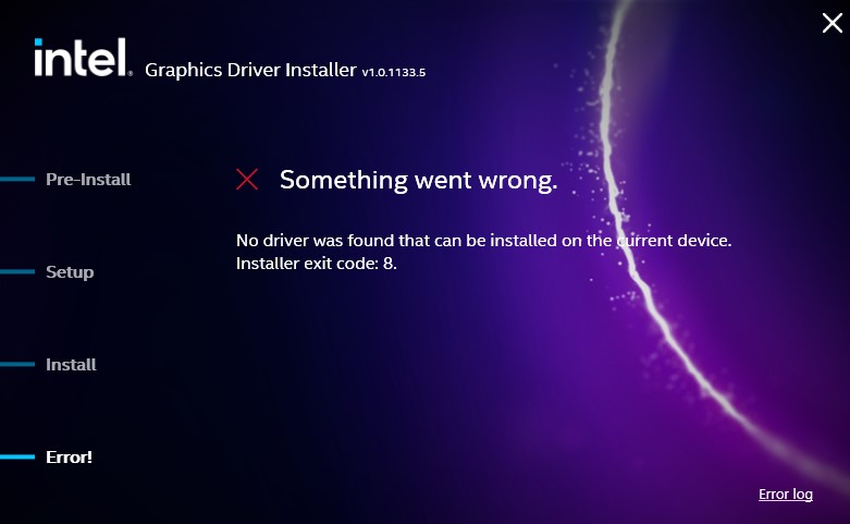

Well, more information, but no solutions.
- I ran the DISM and SFC procedures. Found a few problems in SFC and repaired them. Re-booted.
- Fixed a few Errors found in the Event Viewer log: "Session "Microsoft.Windows.WindowsUpdate.RUXIMLog" failed to start with the following error: 0xC0000035", "Session "Microsoft.Windows.Remediation" failed to start with the following error: 0xC000003" and "Session "NT Kernel Logger" failed to start with the following error: 0xC0000035". I restarted and checked Event Viewer between each fix.
- Tried running Intel DSA again - still got the "Something went wrong" error.
- Tried installing the graphics driver from Intel's Download Center (gfx_win_101.7082). That failed as well error message and log are attached.
Now, I am stuck again as to what to do. Looking for advice, and please remember that this all started by just trying to keep my system updated: I do not have any breakage issues (yet).

I did everything as suggested in the troubleshooting guide. No change: neither the DSA or the direct install of the graphics driver work. Same issues.
