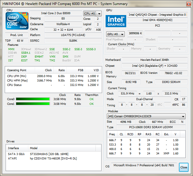

By the way HWInfo shows another BIOS date:

I flashed BIOS successfully. The utility even warned me thah my current version is 2.02 and I do need to udate BIOS. But I flashed it one more time. And still no result.
idata
12,599 Views
The only that is strange - BIOS date differs from BIOS date on HP's site. I flashed with that BIOS.
