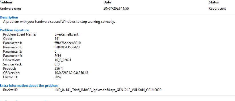

the code is correct of apex and yuzu still same issue no fix for latest driver for intel UHD 750 and try use DDU to remove driver and install it again no fix
same crash and same problems i talk about before
this what i got when the crash happen and distortions on the screen
Hello @Khalilbel
Thank you for your reply.
Please provide us with the following information:
- Intel System Support Utility (Intel SSU) report.
- [Download the Intel SSU](https://www.intel.com/content/www/us/en/download/18377/25293/intel-system-support-utility-for-windows.html?)
- Open the application and click "Scan" to see the system and device information. By default, Intel SSU will take you to the "Summary View."
- Click on the menu where it says: "Summary" to change it to "Detailed View."
- To save your scan: click "Next"; then "Save."
- Intel® Graphics Command Center report:
- Open the Intel Graphics Command Center
- Navigate to the Support tab
- Select System Diagnostic
- Click Generate Report
- Select Save and name the output file.
Also, let us know the game/software version of:

Hello Khalilbel,
I hope you are doing well. We would like to check if the Figma concern will be resolved by the latest driver release 2/26/2024. Kindly download and install the driver version: 31.0.101.5333 and let us know it was able to fix the issue.
If the issue persists kindly send us logs and crash dumps. You may see the steps below, for your reference:
Gather Application logs from Windows Event viewer "Windows Logs"
- Press the "Windows key" + "R" and type in "eventvwr.msc", then click “OK” to run the Event Viewer.
- Under "Event Viewer (Local)" > "Windows Logs", select the Application - to collect "Application Logs".
- To Save the event log. Click menu "Action" and select "Save All Events As…".
- Save the log file with your desired file name and location.
Generate Windows dump file to help us with the analysis of your concern - https://learn.microsoft.com/en-us/troubleshoot/windows-client/performance/generate-a-kernel-or-complete-crash-dump
- Follow the "Manually generate a memory dump file" procedure from the link. This command notMyfault.exe/crash will trigger BSOD which is part of generating dump file. Make sure that this data is saved and all closed prior executing this program.
- These are just examples of where the dumped files are normally located. The location might've been changed prior to running the tool from your end.
- Small Memory dump - C:\WINDOWS\Minidump directory.
- The Kernel and Complete Memory Dump - %SystemRoot%MEMORY. DMP.
- Note: The Kernel and Complete Memory Dump is a huge file(approximately around 2GB). We would suggest to consider sharing it with us via Google Drive. It is important for us to gather all the information necessary to provide you a better recommendation in resolving your concern
