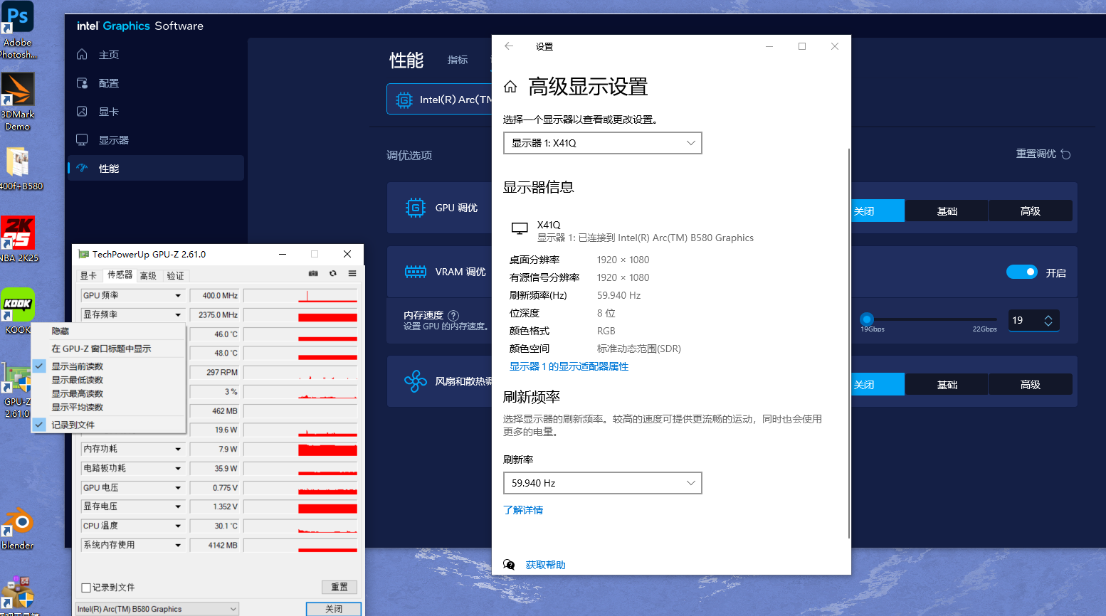

Hi, I recently bought an ARC B580 Maxsun 3 fans oc graphics, and after a few days of experience, I think this graphics card is very good. But I've also recently found an issue with the Memory Clock.
1. The Memory Clock is maintained at 2375MHz continuously, even in standby and 1080p60Hz conditions
2. The software cannot change the Memory Clock, even after applying the change, it still does not change.
This is sad because we all know that it is not reasonable to continue to operate at high frequencies at full load.
The above text content can be reflected in the GPU-Z in the attached drawing.
We look forward to hearing from you soon.

Thanks for your answer! 😀But I still haven't been able to solve this problem with the memory frequency that persists at 2375MHz, and I still don't know how to fix it in the BIOS.I use UEFI and set aspm to level 1 entry.
basic information:
Processor:Ryzen R5 8400F(pbo2 to 4950mhz)
  • Motherboard:msi B650m gaming wifi(7E30v192(Beta version))
  • RAM:16G*2 6000mhz C36
  • Operating System version:Windows 10 22H2
  • Power Supply:Super Flower 650w
  • GPU:Maxsun B580 12G OC(32.0.101.6458_101.6257 WHQL Certified)
