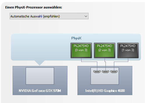

Unfortunately, I found out that I can't use all three monitors at the same time under Windows 10.
It should be said that my laptop screen (built-in) is already broken and therefore no longer recognized by the hardware, unlike the three Ilyamas.
The system recognizes all three (see screenshots), but in the Windows settings the third one is grayed out and in the Intel settings I'm not even given the option to use all three at the same time.
However, I can always use two different monitors at the same time. (1-2, 1-3, 2-3)
I have tested two driver versions:
- 10.18.15.4248 (the last official version released by MSI)
- 20.19.15.5171 (the latest version for the HD4600 from Intel).
Unfortunately, neither of them work, as well as the default Windows driver.
But in fact, on Linux live systems (USB) it works immediately, without dedicated drivers and without problems.
Now my question is: what is the problem? And is there possibly a way to "patch" the Intel driver via the registry, a config or something similar?
