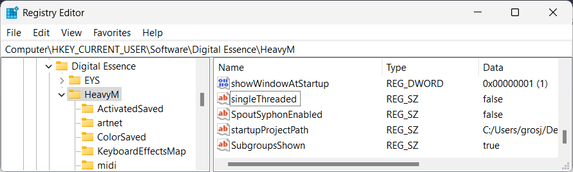

To force single threaded mode, one has to create the "singleThreaded" registry key as shown in the image below (nb: it has to be a string with either "false" or "true" value)
