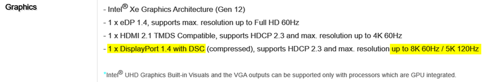

With these criteria, you can also consider using an ASRock B760 Pro RS WiFi as a motherboard. This motherboard has physical connectors that allow you to use the full graphics capabilities of the UHD770 built into the Core i7-12700K:
But no matter which motherboard you use, if you don't install a graphics card in the PCIe slot, the BIOS will automatically use the one integrated in the processor. You just have to make sure that you buy a processor model with integrated graphics. There are also some without integrated graphics. For the 12th Gen processors, these would be the so-called "F" models, so the Intel Core i7-12700(K)F, for example, would have NO graphics.
