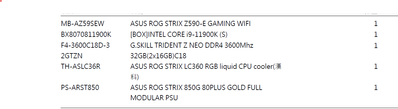

Hello. This is long story and makes me crazy.
I build my PC on May-2021.
Here is the detail:
In addition, I upgraded to 64GB ram with the exactly same model. So now it is 16GBx4.
My PC also have discrete graphics RTX3060. But my monitor is connected to the motherboard. (integrated display).
There are two problems bothering me. One fixed and another one still insist.

Actually, this is my second i9-11900K. My first 11900K with the same problem plus BSOD. The first CPU on ASUS SP value is very good. it got 87. But it is always BSOD with non-OC and light load. So I have to RMA. During RMA process, I wait for around 4 weeks. At this period, I bought an Intel Pentium Glod G6405 for a temporary purposes. The funny thing is those above issues/problems never come up.
After RMA process completed, I got the new 11900K. (ASUS SP value 50, I am so lucky!!)
With this new 11900K, the blank screen problem comes up again. is there something I can do?
