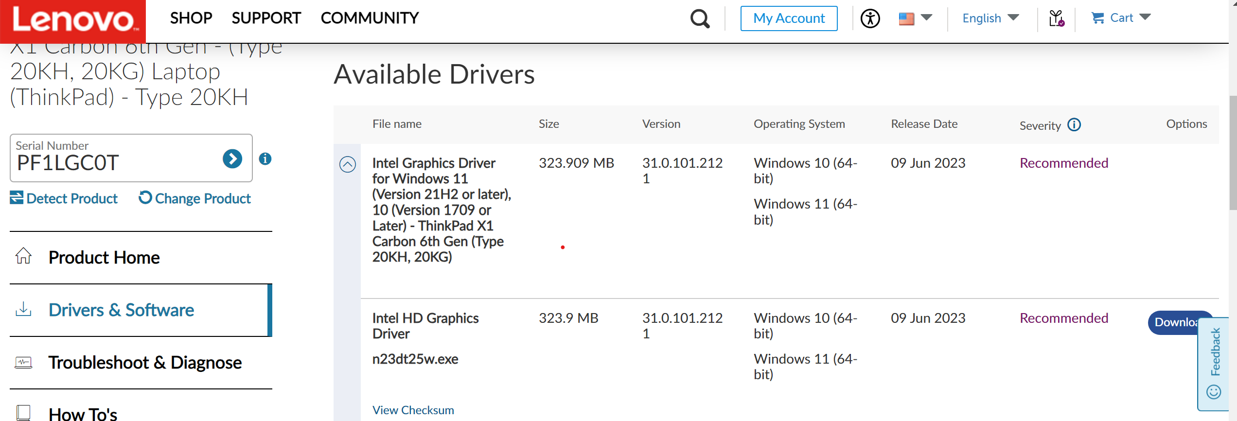

I had the same exact issue yesterday, i.e. Microsoft basic driver works, Intel UHD driver doesn't.
After going through all the usual suggestions I came across an unrelated post but it did explain how to get the previous drivers by editing the final number in the URL for the most recent driver which is available from the driver update page on Lenovo's support page for your model of laptop.
So for me I required the "Intel Graphics Driver for Windows 11 (Version 21H2 or later), 10 (Version 1709 or Later) - ThinkPad X1 Carbon 6th Gen (Type 20KH, 20KG)"
The URL for the latest version of this this can be found by right-clicking the download button and "selecting copy link address", see attached image) and is:
https://download.lenovo.com/pccbbs/mobiles/n23dt25w.exe
Previous versions include
https://download.lenovo.com/pccbbs/mobiles/n23dt19w.exe
https://download.lenovo.com/pccbbs/mobiles/n23dt20w.exe
https://download.lenovo.com/pccbbs/mobiles/n23dt21w.exe
https://download.lenovo.com/pccbbs/mobiles/n23dt23w.exe
https://download.lenovo.com/pccbbs/mobiles/n23dt24w.exe
The 19 version worked for me, so I didn't bother trying the later ones.
