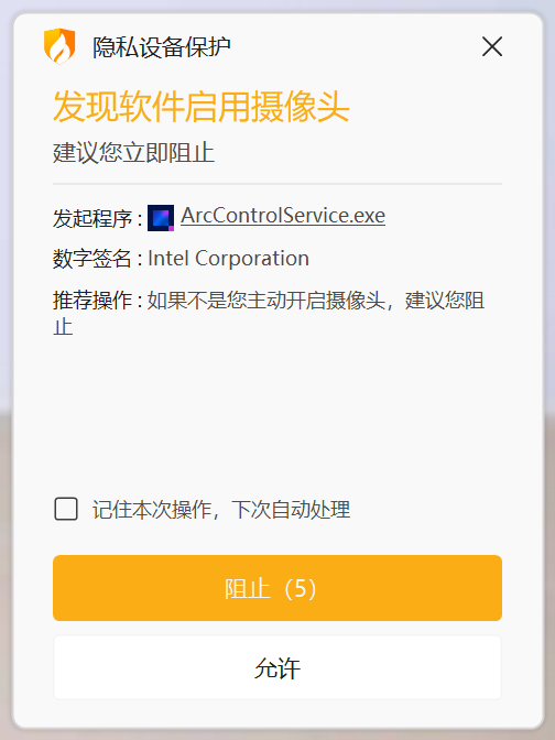

It's dangerous
Why does the driver call the camera

I'm using a desktop computer. There is an antivirus software called "Huorong Security" installed on my computer. This software can detect whether an application is accessing the camera or microphone, and it will pop up a window to prompt users whether to allow the application to use the camera or microphone. When the system starts up, this antivirus software detects that your graphics card driver program, ArcControlService.exe, is using the camera (as shown in the picture just now).
However, I've noticed that your Arc graphics card driver has a function to use the camera in the screen recording area. Perhaps you just want to check whether the camera exists when the system boots up, rather than secretly using the camera to record in the background as I thought. You could make a slight modification so that the detection of whether the camera exists is carried out when users start using the camera for recording.
Of course, these are just my speculations. If possible, I hope you can download the "Huorong Security" antivirus software and then carefully debug your driver program to try to avoid being detected and prompted by the antivirus software.

Thank you for sharing this information with me. I would like to further inform you that the Arc Graphics Driver includes a feature called Virtual Camera, which is used for screen recording and taking screenshots via Arc Control. Therefore, there is no harm in allowing it to access your camera, microphone, and speaker, as all of these are utilized by the graphics driver.
