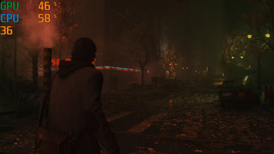

Hi there, Ive bought Alan Wake 2 again now on PC abut when I installed the game and test it out on my PC which contains:
-Ryzen 5 5600g
-Intel Arc A750 8gb
-32GB RAM DDR4 2666MHz dual channel
-Windows 11 Pro
and the game is installed in a ssd m2
no matter what settings I use or what resolution I change, there will be always be around 33-40fps no matter the scene even looking at the floor, there will be always be like that which is odd since this GPU could play this game at 60fps at least on low settings
In those screenshots, I tested the Alan scenario (case 2) and medium settings at 1080p with FSR2 at quality, like I said no matter the settings I change, the result always stays around 35fps
And of course my drivers are up to the day and I have ReBar enable
Thanks for reading and hope you can help me with this problem, pls do not forget us Intel Arc A-series users

Hi there DeancR! thanks for answering
I installed the lastest driver update (32.0.101.8135) using DDU to unistall the older driver and test the game again but the results are basically the game.
I actually did a CapFrameX test for 5 minutes but im going to be honest with you, I dont know how to use it so I will just summit some screenshot that might help you but again, I dont know how to use it so im sorry if it not that useful
Heres the report from SSU:
And heres the settings I use for Alan Wake 2 but again, it really doesnt matter what settings I use the results will always be the same, I have to change from fullscreen to borderless to take those pictures but I played the game on fullscreen
Thanks for taking your time trying to help me and I hope we could solve this problem quick .

Hi again DeancR! thanks for taking your time looking into the alan wake 2 problem, hope we can solve it soon!
I didnt know there was a new update to my BIOS so I did what you told me and I updated it, heres the proof
After I updated it I retest Alan Wake 2 but the results are the same, still the same fps so theres no improve there
And finally I send up the json file as you request as a 7z file since the forum doesnt accept json file
Hope it can help you in your research and I look foward to read more news about it soon!

Hi Matertorneo,
Thank you for your patience as I investigated the Alan Wake 2 performance issue you're experiencing with your Intel Arc A750.
After reviewing your comprehensive testing data, including the CapFrameX results and BIOS update confirmation, I have an update regarding the performance you're observing.
Based on our analysis, the FPS you're experiencing (33-40 FPS) is actually in line with expectations for the Arc A750, which delivers performance comparable to the RTX 3060 in Alan Wake 2. The CapFrameX data indicates that your system performance is being bottlenecked by the CPU during testing.
It's important to note that Alan Wake 2 was originally designed with a 30 FPS target in mind, prioritizing visual fidelity and atmospheric presentation over high frame rates. According to reports from the gaming community, even high-end PCs are experiencing difficulty achieving very high frame rates without the use of upscaling or frame generation technologies.
You can find similar experiences from other users here:
- Alan Wake 2 locked at 45-50fps no matter the settings: https://www.reddit.com/r/pcgamingtechsupport/comments/17d8p3v/alan_wake_2_locked_at_4550fps_no_matter_the/
- Alan Wake 2 performance thread: https://steamcommunity.com/app/1329500/discussions/0/3883644315769757473/
For game-specific optimization inquiries, I recommend contacting the Alan Wake 2 development team directly, as they would have the most detailed information about performance optimization and potential future updates. I will be closing this thread and no longer be monitored.
