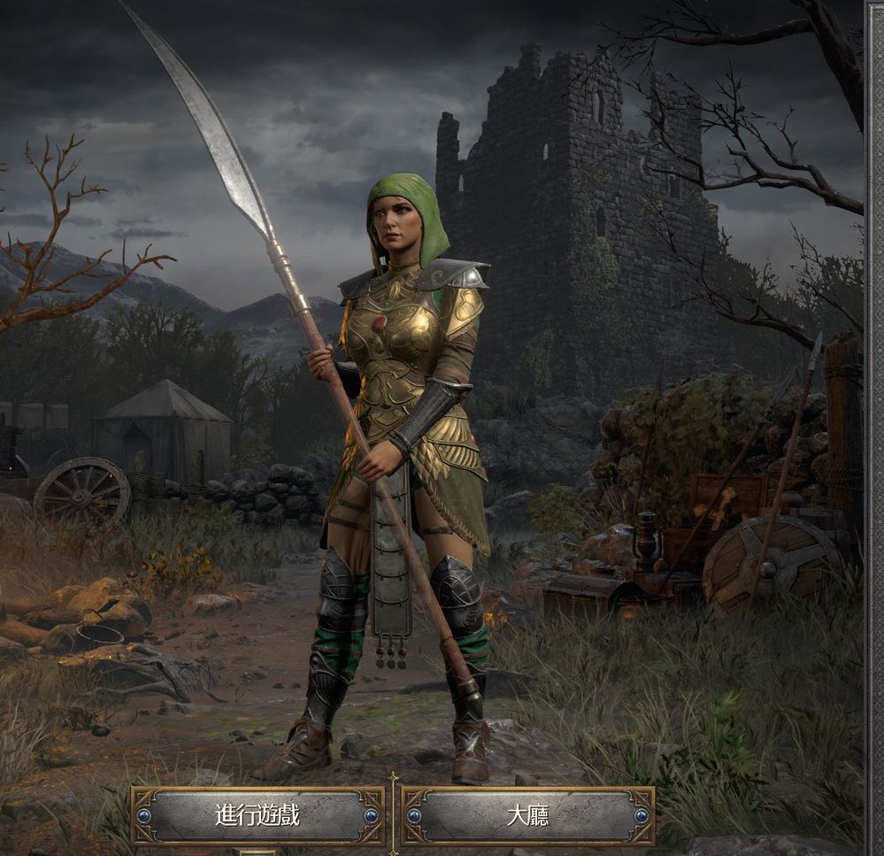

problems:The weapons on hand cannot be displayed, and the status of the altar above the head is displayed in a mess

Thank you for posting on the Intel® ARC™ Graphics Communites. I know graphics glitches like weapons not showing or in this case icons from the shirnes not rendering properly can interfere in your gaming experience. We will be glad to help with this one.
I see the screenshot showing the weapons issue is from the character selection screen, could you please let us know if the issue is also happening during regular gameplay or if is it exclusive to character selection?

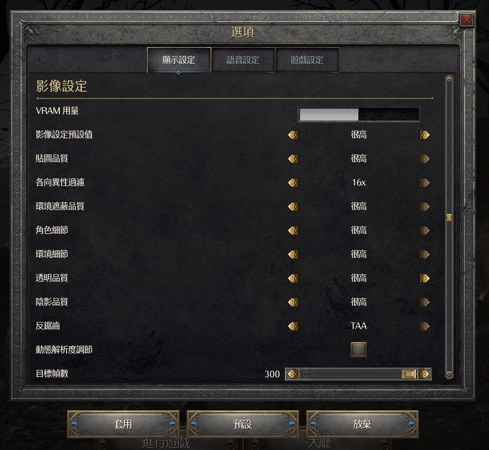

We would like to get your system information as well so we can the hardware and driver in which you are running the game, so please share with us a log file from the Intel® System Support Utility, along with the log file please share with us a screenshot of the in-game graphics settings so in case we need to test this in our lab we can configure the game the same way as you are playing it.

1.Even in the game, the image of the weapon cannot be displayed.

3.My game is in Simplified Chinese, and I couldn't find an English version, but my settings are all set to the highest default.Provide a clue that when I set up the environmental masking variety, there is a weapon that can display its appearance, such as the final screenshot, although it is very blurry.

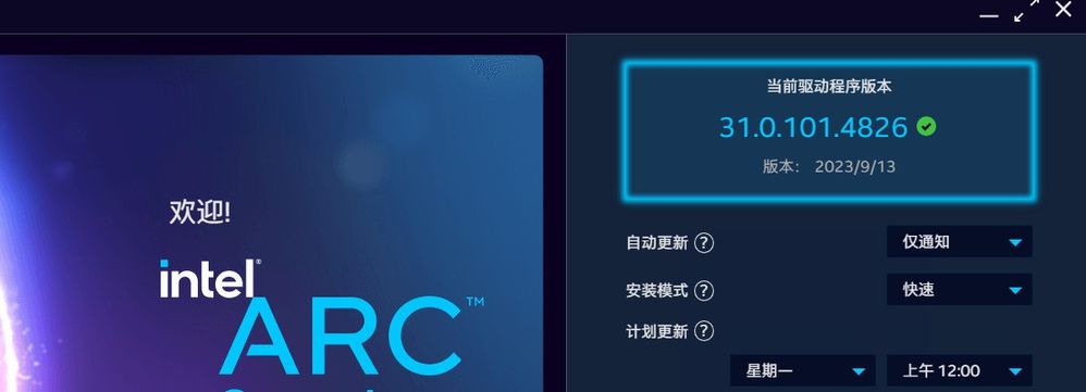

I have switched to the 4502 version driver and it can display normally

I wanted to check if you had the chance to update your BIOS and OS to their latest version as recommended in our previous post. Also, please note there have been a couple of driver updates with some improvements please update and test the driver 31.0.101.4887 and check if the same issue happens.
