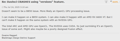

The "versions" way of crashing seems to NOT be only an arc b580 issue.
Im not an expert, i don't know if this means only davinci-resolve can do something about it, or gpu drivers can aswell etc, but here's what they said:

Hi @Danyyy3l
Thank you for providing that video.  That is similar to what I see. There is no specific set of steps that are guaranteed to reproduce the error, but it will eventually happen.  I agree with the Black Magic assessment that it is an OpenGL/OpenGL interop issue.   The driver,  reports OpenGL 4.5 compliance, but, doesn't actually meet that compliance within that API expected by Resolve's OpenGL backend. That is what the logs I submitted point to, e.g.:
(UI.GLInterop | ERROR| ... | MainPlayer: Failed to get texture HandleXXXX is unknown
 DVIP Exception: OpenCL error - API: OpenCL - API Error Code: CL_OUT_OF_RESOURCES (-5)
[UI | ERROR| ... | Invalid handle, and failed to get previous texture],
etc.
These, combined with the OpenGL entry point errors on startup and "OpenCL_OUT_OF_RESOURCES" errors are symptomatic of the display/UI system failing to get expected data from the GPU after the OpenCL processing step fails.  It fails (or times out, which is why you don't see the app crash every time, it just freezes) from user interaction within the program, usually after some editing.
Check your dxdiag report for the TDR errors (LiveKernelEvent 141 entry). That is when the GPU stops responding and Windows tries to reset the driver.  This suggests the driver isn't using the right language for the Windows kernel or core system libraries, not an application (Davinci Resolve) error.

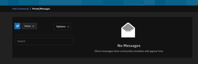

@Danyyy3l @iamdavid I’ve sent you a private message regarding the status of your request.
Danyyy3l
1,823 Views
I haven't received any private messages.
Can you send again?
