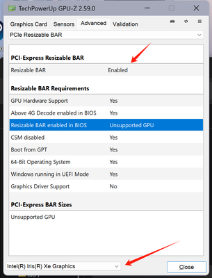

Hello Evan_Hou,
Thank you for this information.
To clarify on the screenshot that you attached wherein it states that the Resizable BAR is enabled, is that on Windows 10 or Windows 11? Additionally, you missed to provide this information to me.
- You said that the only workaround that worked was using Windows 10, are you referring to the problem with the unsupported Resizable BAR and incorrect driver versions being detected?
I'm looking forward to hear from you!
Jed G.
Hi Dear JedG_Intel,
Sorry, it is supported on windows 11, and the version number I think is a conflict with IRIS integration, and it does not affect the use. But that's okay, I'm using it on my desktop computer. The BIOS of the mobile computer is Resizable BAR.
It's just an interesting hardware issue. Thank you again for actively tracking the issue.
Thks,
Evan.

Hi Dear JedG_Intel,
I don't know how to say it. Just hope you guys can figure this out. Two GPU-Z images are attached:
Hope this helps you out.

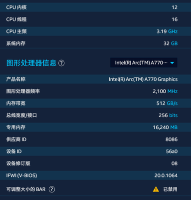

Hi Evan_Hou,
I would like to confirm if the issue you are referring to pertains to the Resizable BAR feature? If so, could you please provide a screenshot of the Resizable BAR status using Arc Control? This information will assist me in verifying whether the feature is enabled directly through Arc Control, rather than using a third-party application.
Jed G.
Hi Dear JedG_Intel,
There is no language option in your control panel. You might as well make do with it.
Thks,
Evan.
Hi Evan_Hou
The language displayed on the Arc Control interface is determined by the system language settings. To facilitate a clearer understanding of the screenshot's contents, please change the system language to English and then reattach the screenshot.
You may refer to this link: Manage the input and display language settings in Windows
I hope to hear from you soon so we can find a resolution to this as soon as possible.
Jed G.
Hi Evan_Hou,
Based on the photo that you attached, the ReBAR is disabled while using Arc Control and this means that the feature might not be available with your system. I highly recommend that you get in touch with your motherboard manufacturer to check if you can enable this feature with your system.
Should you require further assistance, please don't hesitate to let me know.
Jed G.
