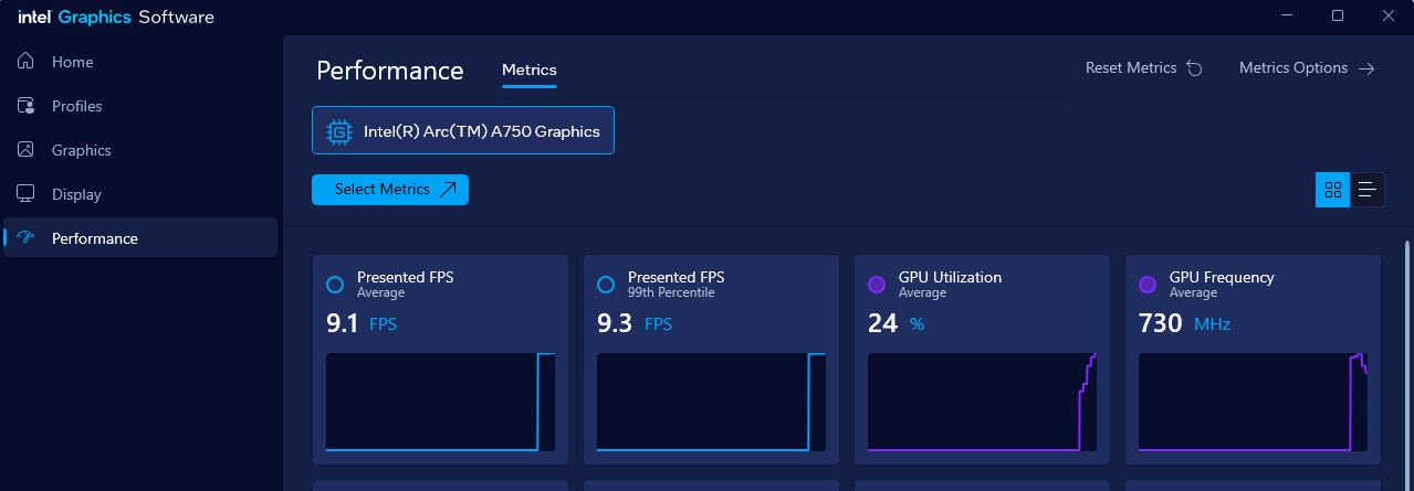

I apologize for not being available for a few days.
I also tried reinstalling the new driver and rolling back to the prior one, but it did not help.
After restarting or starting my computer, IntelGraphicsSoftware.service seems to be operating in services, but Intel Graphics software does not. I tried running it manually, but it does not appear. After terminating the IntelGraphicsSoftware.service, I attempted to start the Intel Graphics program, it opens but no tuning choices were displayed. In addition, Intel Graphics software is enabled in the Startup options.
I have included some screenshots. Please assist me. My GPU reaches 50 degrees ideally when the fan is not spinning by default.
