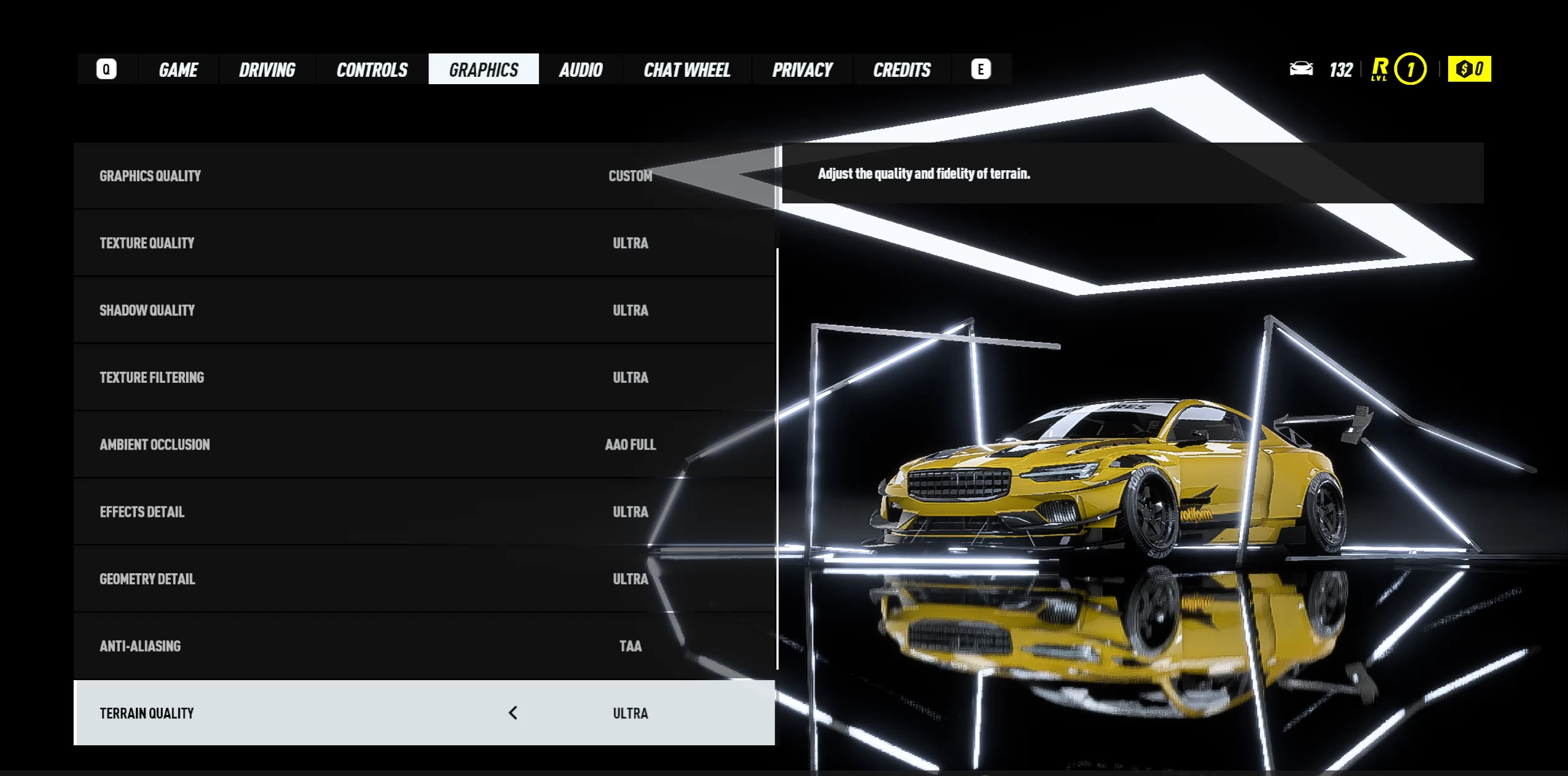

cabeswater
9,797 Views
Hi Dhanniel!
Here are the prints.
On 1440p, 85% resolution scale, all on the ultra, vsync off.
