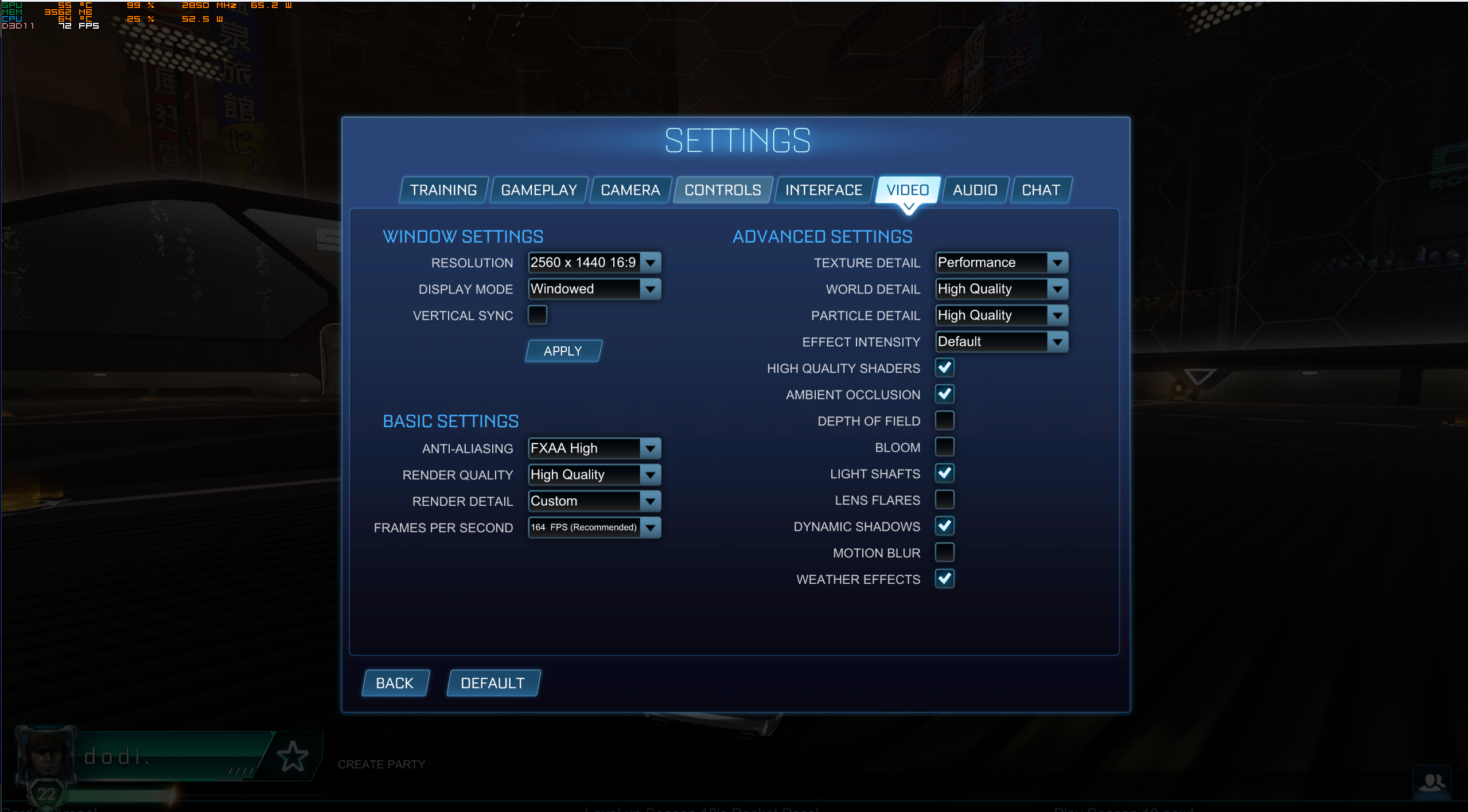

On my system, the Steam version of Rocket League has a low GPU power draw and framerate, it even occasionally crashes with a blue screen. The Epic version runs completely fine though, much higher fps, normal power draw and no crashes.
In the Intel Graphics Software, the Steam version of Rocket League wasn't automatically added as a profile, only the Epic version. Manual scanning doesn't make it appear either. However, I don't know if this is related to the issue.
Before the recent driver update, the Steam version ran normally. So I tried to uninstall the driver via DDU and use an older driver but that didn't fix the issue.

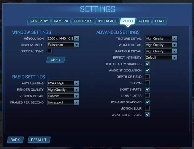

I wanted to provide you with an update regarding the performance testing conducted using our Intel® Arc™ B580 Graphics, based on the game settings you provided.
The game on Epic settings using graphics driver versions 32.0.101.6651, 32.0.101.6653, and the latest version 32.0.101.6734. I am pleased to inform you that we achieved high FPS rates during the testing. The average FPS recorded was 327, with a low of 210, which is significantly higher than the average FPS of 160 you reported on Epic settings.
Additionally, we attempted to locate the game on Steam, but it appears to be currently "unlisted" in the Steam store.
To further assist you, I kindly ask you to:
- Explain how he installed Rocket League on Steam. Did he use the manual "Add a game" option, similar to this [https://help.steampowered.com/en/faqs/view/4B8B-9697-2338-40EC]?
- Try setting the "Frames per second" to "uncapped," as we noticed in the screenshot, you provided that it is capped at "164 FPS (Recommended)." This option was not available during our test. Then, check if there is any improvement in FPS performance.
Please see simulation result below. I look forward to your response.

Hi Randy,
thank you for your update on my problem.
Regarding your first request to me: I acquired the game on Steam back in 2018, before the game developers sold their soul to Epic Games, who made the game exclusive to their launcher. I am afraid You would have to get access to a Steam account, that paid for the game before September 23rd in 2020.
For your second request: I am certain I will achieve much higher FPS if i set the settings to "uncapped", but I am not trying to. My monitor is on 164Hz, so more FPS would only draw excess power. Really, my only concern is the performance discrepancy between the Steam and the Epic Games version after installing the new driver.
dodi
