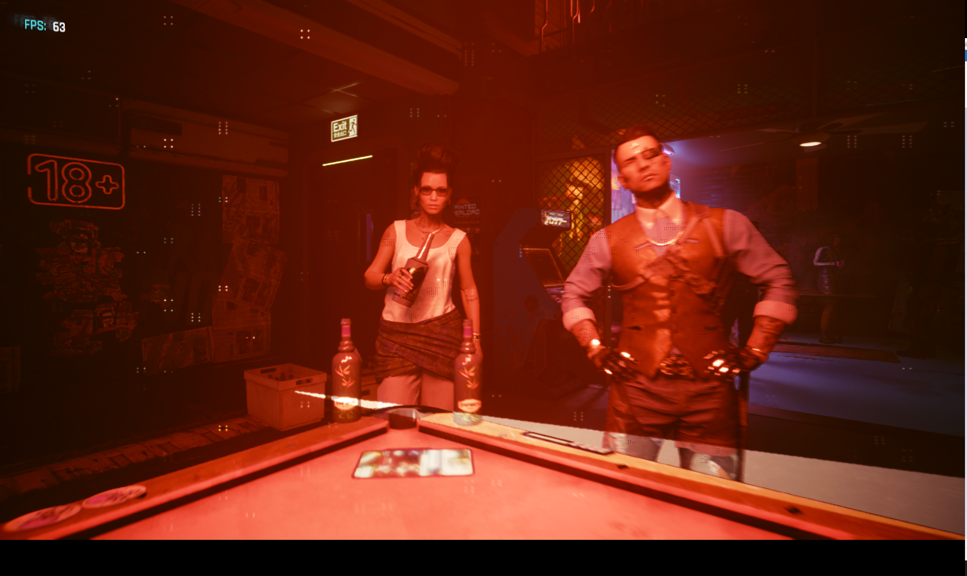

I have recently purchased the AsRock Challenger B580 and am experiencing extreme artifacting over two games so far, Dyson Sphere Program and Cyberpunk 2077.
I have installed the latest intel driver after using DDU and am on the current motherboard driver as well.the SSU is attached (with networking removed). Rebar is enabled, power settings changed as well to L1 and  maximum power savings.
Starting with the dyson sphere program, I have narrowed this artifacting to the "Dithering" setting. Turning this on shows white squares around the screen that flicker in different places, which gets worse when VSync is enabled. Turning this setting off, the artifacting goes away. I do not know what Dithering is and will leave it off for the time being. See the png of the artifacting.
Moving onto cyberpunk, the artifacting is consistent, and one sporadic. There are three types, two are lighting issues, at least i believe both to be. The consistent issues is one, white circles that appear in clumps together, on characters and objects that almost flicker. The other is little black dots on the characters. The sporadic one, triangular lighting that appears across all objects, even if there is a wall in the way.
There is also an issue when loading, a black bar will appear across the screen for a brief second, and return to normal. I could not capture this happening. Did not happen with the 1660 super.
The first two issues noted, the white (look like stadium lights) and black dots on the characters, appear on every setting listed, ultra with or without raytracing, and on low with everything off. The triangular lighting appears randomly, sometimes on the lowest settings, sometimes on ultra, and sometimes not at all. I do not know what causes any of these issues. I thought the white dots were normal, the game was supposed to have them there, but looking at a benchmark test on youtube, there are none. I have restarted multiple times, uninstalled and reinstalled the driver, these issues still occurred.
I originally had a Ryzen 5 3600 installed, thinking this could have been the issue, I purchased a Ryzen 7 5700X3D, issues persisted after new install.
Screenshots are attached with all of these issues shown.
Is this a GPU issue, driver issue, ram issue? I have run tests on the ram and they have come back normal. CPU is normal. I have not switched the GPU out yet with my older 1660 super, that had zero issues.
Thanks.
(Edit, before installing the current drive after DDU, changing the graphic settings in cyberpunk would cause the screen to artifact. It was just in the settings menu, I did not test this in gameplay. installing after DDU seems to have fixed that issue, dont know if this matter or not)

I'm afraid it's an RMA right before christmas then. 750W should be plenty to power that system, and those artifacts - while not as significant as I've seen before - just screamed beginning VRAM failure. I'd suggest you return the card then.
Just out of curiosity though - did the "stadium lights" you encountered match up with my capture?
Grofree
14,105 Views
That is what I am thinking unfortunately. I couldn't get the video to play so im not certain. These white dots are in small clusters of 4 to 6, they dont move on their own, they move with the camera over anything else, like the camera itself has dots on it.

Edit: I've seen your screenshots with those white dots (and some weird light reflection on the edge of the pool table). Those definitely aren't supposed to be there.

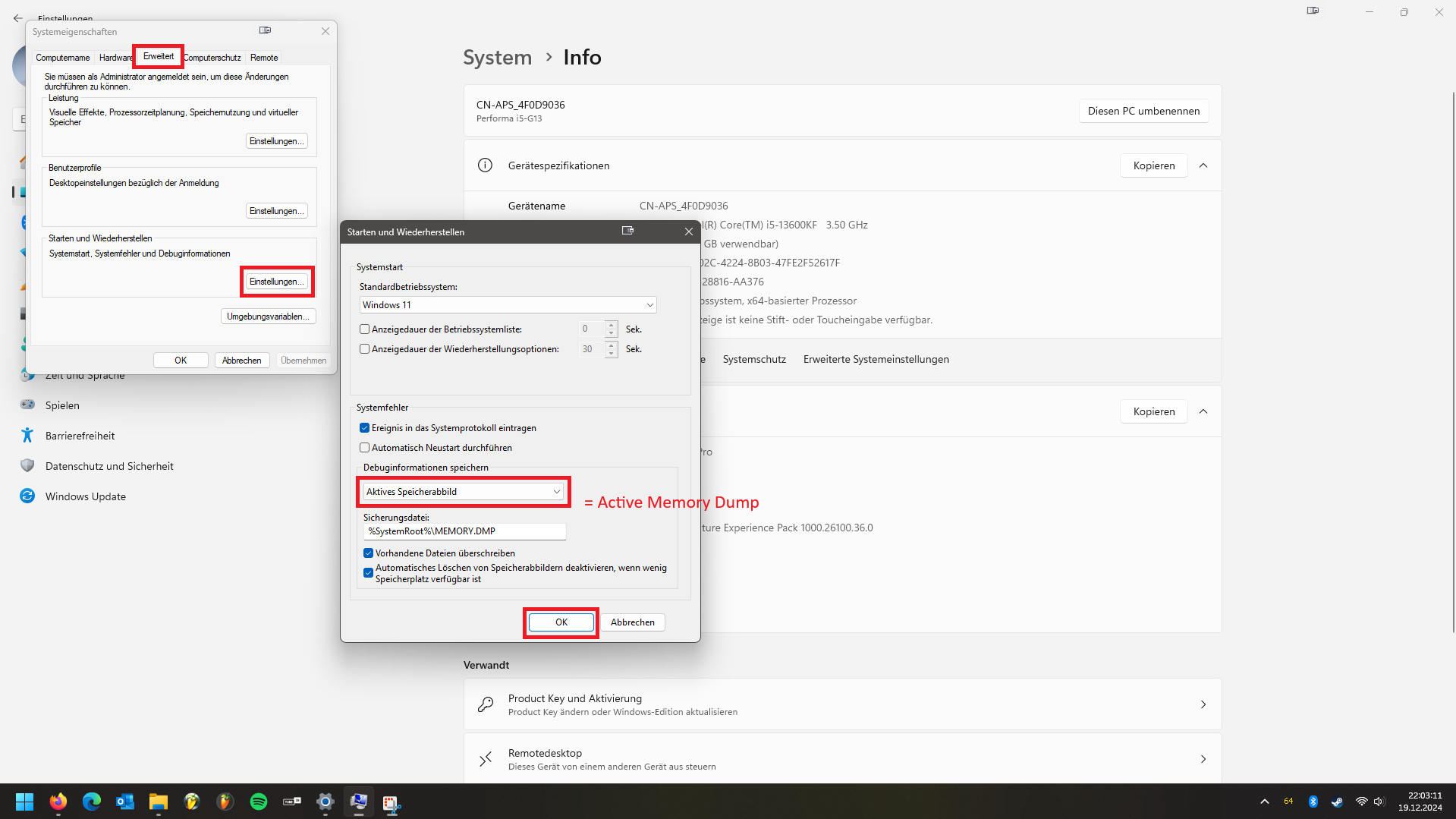

Edit: I've uploaded an active memdump to the OneDrive mentioned above from running the benchmark when the lighting error ("stadium lights") was visible. If you'd like to also provide such memdumps, please continue as follows:
  1. Using RegEdit, add the values mentioned in this MSDN article (or use the attached crashonctrlscroll file, inspect it and if you'd like to apply remove the .txt extension after downloading it)
  2. Make sure you've activated "Active Memory Dump", see screenshots 2-1 to 2-5 attached
  3. Reboot your system
  4. Close any applications not necessary to run the game - especially any open browser windows, E-Mail applications or anything containing private information or passwords!
  5. Run the game with settings of your choice and start the benchmark
  6. Once you encounter glitches/artifacts - depending on your keyboard:
    1. Press and hold Right Ctrl, double-tap Scroll Lock (between PrintScrn and PageUp) or
    2. Press and hold Right Ctrl and Fn (Function key), double-tap Scroll Lock (between Insert and PageUp, toggle for Home)
    3. If none of the aforementioned layouts match, try finding out which key (combination) might be Scroll Lock by observing the LEDs on your keyboard - if it's got status LEDs, the rightmost should indicate that Scroll Lock was engaged. Refer to the manual if necessary.
  7. Your system will crash - let it finish generating the dump file then restart manually if necessary
  8. Once restarted, go to C:\Windows and cut the MEMORY.DMP file; paste it to a OneDrive folder or similar
  9. Post the memdump link here
Please note that these memdump files will likely approach 10 to 15 GB in size, depending on your system configuration and running background applications.
