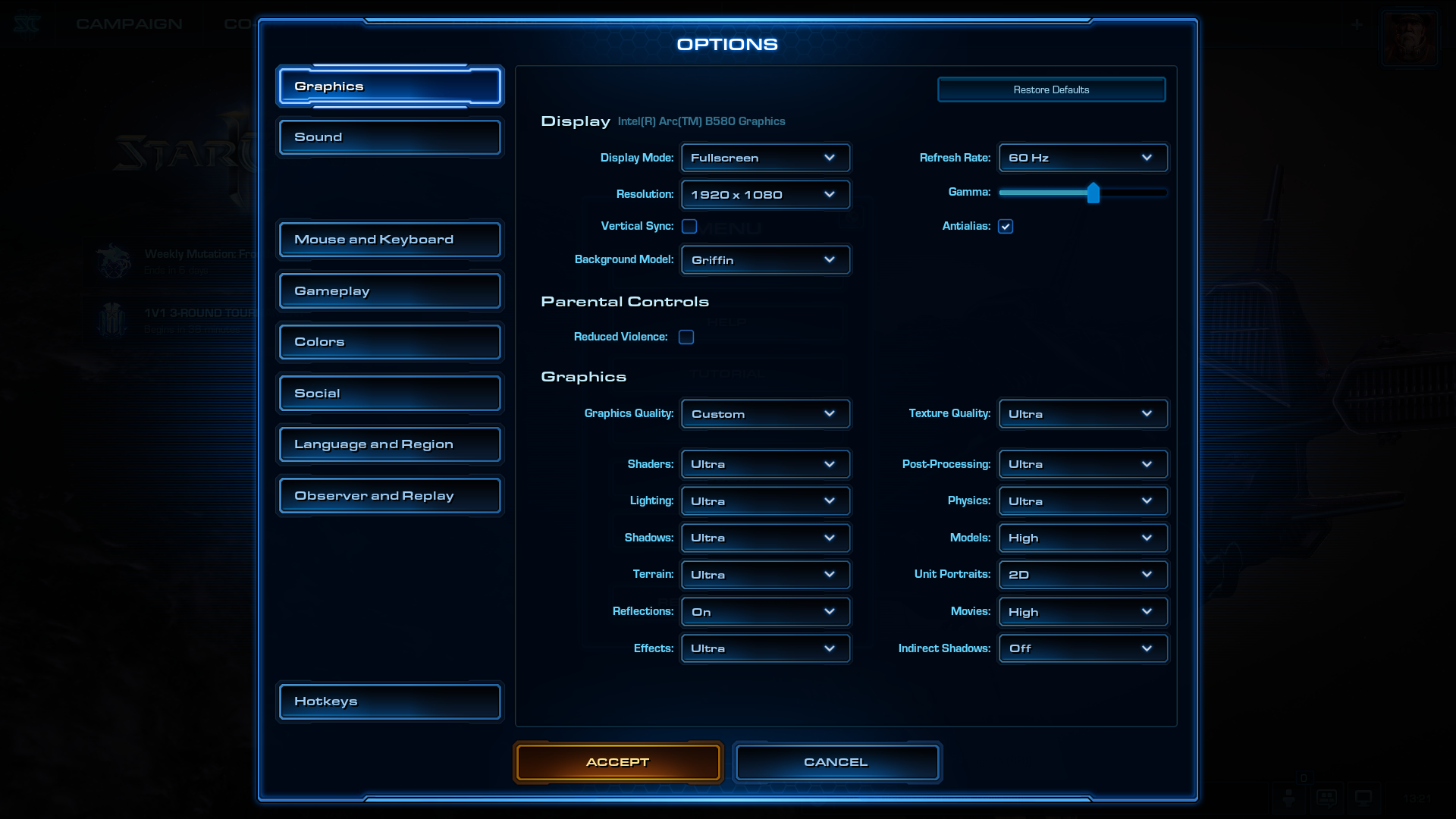

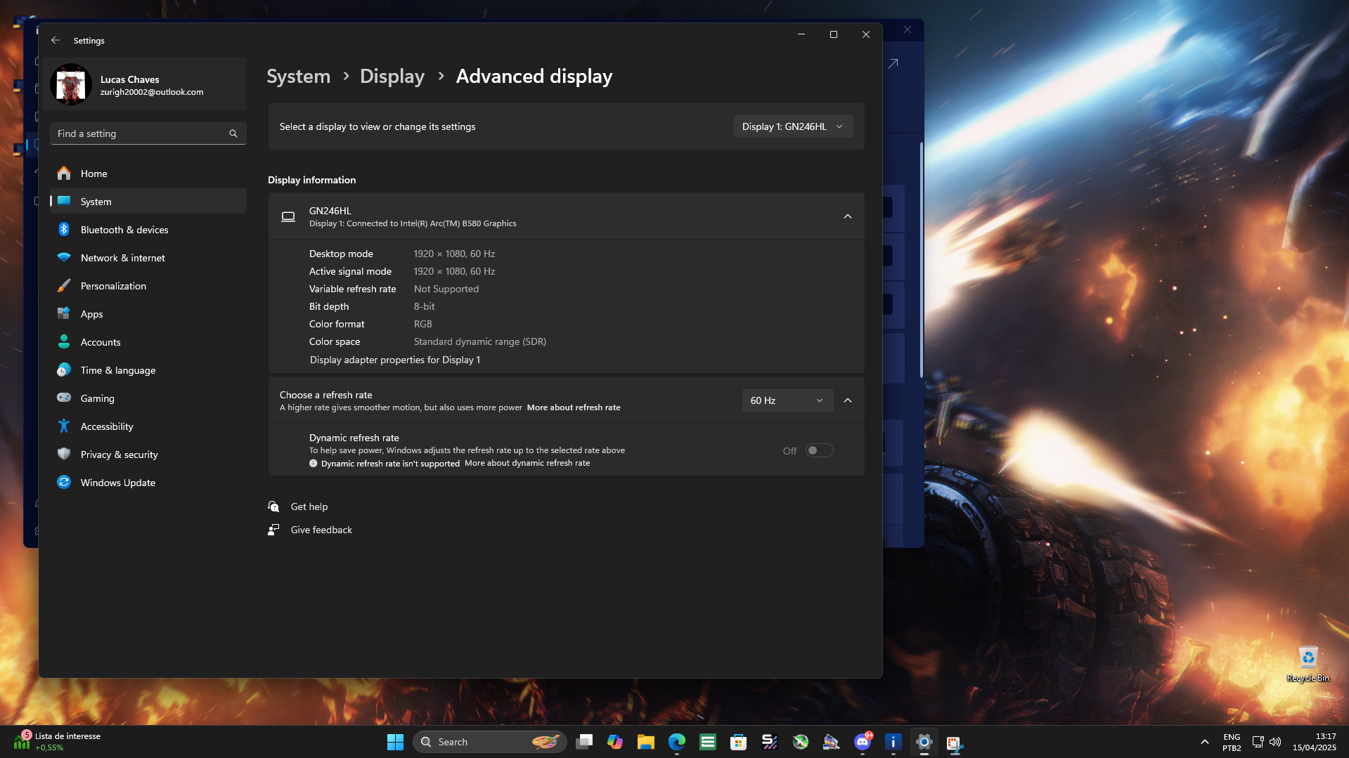

Bem, eu atualizei recentemente. Eu tinha um GTX1060 6 GB, o que me dava 144 Hz a 1920x1080 no meu monitor; no entanto, com minha recente compra do Arc B580, usando o cabo Ugreen HDMI 2.1, ele está me dando apenas 60 Hz a 1920x1080. Baixei o DDU para desinstalar drivers gráficos antigos, instalei os Intel e nada mudou; Eu ainda tenho meus 60 Hz.
Meu monitor é um GN246HL ACER, com entradas HDMI, VGA e DVI.

I think I've "discovered" the problem, as I said, my monitor has HDMI, DVI and VGA inputs. It seems that the monitor only delivers 144hz over DVI, which seems strange to me, but I think the problem is with my monitor.
Thanks for your attention.

The original query for this post was about the Acer GN246HL gaming monitor. It has a native refresh rate of 144 Hz, but can only achieve this via a dual-link DVI connection. This was also confirmed by product testing. When connected via HDMI, the maximum recognized resolution is 60 Hz. This is also confirmed by the EDID information uploaded by @Drakkar in the first post.
When connected via HDMI, this monitor will behave the same with all graphics cards, regardless of the manufacturer.
