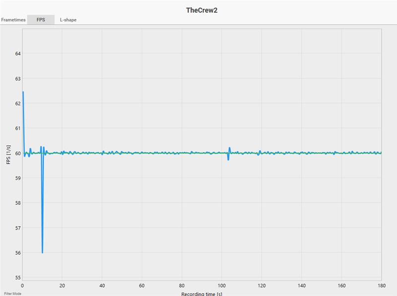

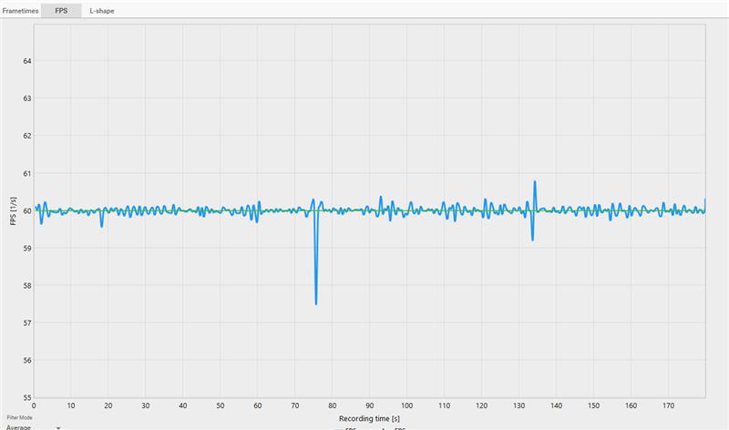

I have attached the logs.
Note:
- Restarted the game for every log capture.
- Played different type of race each time.
- Gameplay is all racing, no cut scenes or loading screen.

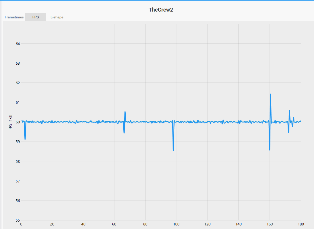

Hi Bilal99,
Thank you for your response. I have tried to reproduce the issue using our B580 and also tried our competitor's graphics card RTX 4060. I would like to confirm that our graphics card is working on par with NVIDIA.
Please see the screenshots below. Please let me know if you have any questions or concerns. Thank you.
