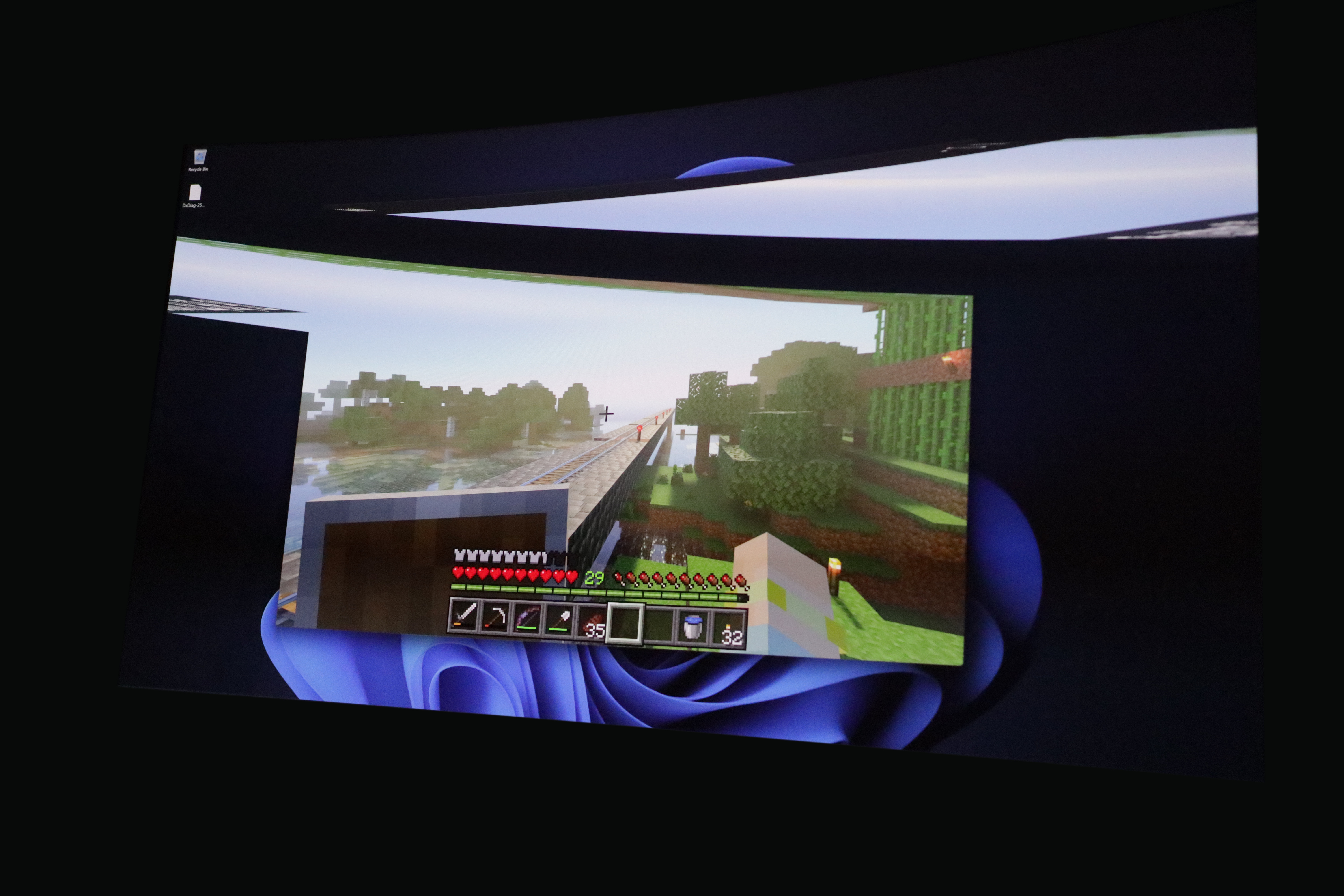

GPU: Intel Arc B580 Limited Edition
Display: AW3225QF @ 2160p 240Hz with DSC
Driver version: 6737
Issue: As soon as I launch any 3D applications, display signal starts streaking (?) diagonally at about 10° from horizontal at about top 10 to 30% of the display area. This issue does not get captured on screenshots and screen recordings (e.g. OBS) making me think it's a connection issue.
Troubleshooting attempts:
- I have tried 3 different HDMI cables: these same cables do not have the issue running the same monitor at res/ref. rate from my AMD 7000-series GPU.
 - Lowering ref. rate to 120Hz: this turns off DSC automatically on my display. The problem does not occur.
 - Trying DP ports: at 2160p 240Hz with DSC, the problem does not occur
 - Trying different driver versions: 6737, 6734, 6732, 6647. The problem occurs on all four versions
 - Not an intentional troubleshooting step, but one thing of interest. When updating from 6734 to 6737, after I rebooted the computer prompted to continue installing driver by Intel® Driver & Support Assistant, I started a 3D application (Mineraft RTX) thinking the driver was already installed. The driver wasn't installed yet and the game started rendering on the iGPU of my 7800X3D but still output on the B580 on the problematic HDMI port running at 2160p 240Hz with DSC (confirmed on my monitor; in case someone asks, B580's driver still showed 6734 and not 6737 nor missing driver in Windows Device Manager). There was no problem with the same streaking as seen when the game is both rendered and output through the B580, although the frame rate was terrible as expected. Once 6737 was fully installed and computer rebooted, the problem came back.
The issue makes the card nearly unusable.
- Is this an issue with my specific card?
 - If not, can this be solved with a driver/vBIOS update?
Attached:
- DxDiag
 - 2 video recordings of issue (frames are blended together a bit but it gives an idea of how the problem manifests)
 - 2 photos of issue and 1 photo showing normal frame (fast shutter speed single-frame photos)
- Videos and photos are cropped to the display for privacy.
I have since tried driver version 6790. Same problem.

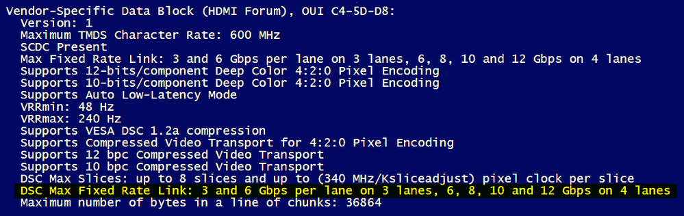

According to an analysis of another AW3225QF, the monitor's EDID advertises the following:
This exactly corresponds to the Coordinated Video Timing - Reduced Blanking (CVT-RB) standard.
4K @ 240 Hz RGB 8-bit = 216% HBR3 / 131% FRL6 > DSC OK
4K @ 240 Hz RGB 10-bit = 270% HBR3 / 164% FRL6 > DSC OK
This connection also appears to be established, but unfortunately with the image error. However, your description is very good and should allow Intel Support to test the problem in the lab.

For further testing, we need the EDID that the monitor sends via the HDMI cable on the Display Data Channel (DDC). To do this, please connect the monitor to the graphics card via HDMI (and only HDMI) and run edid-test.exe:
https://www.monitortests.com/edid-test.zip
This will create a file named "edid-test.txt" in the same folder. Please attach this TXT file here.

That's interesting. The monitor advertises a different video timing via HDMI:
Probably irrelevant to your problem, but this could play a role:
The desired signal doesn't require 12 Gbps on four lanes. Please try forcing your graphics card to a maximum link speed of 6 Gbps per lane. This should result in an DSC signal at 8 bpp.
- Download Custom Resolution Utility (CRU)
 - Run CRU.exe
 - Make sure the active EDID is AW3224QF connected to your PC via HDMI. If necessary, select from the drop down menu.
 - Proceed as follows:
Please change the maximum FRL rate to 24 Gbps, close all CRU windows with OK and restart the computer.
