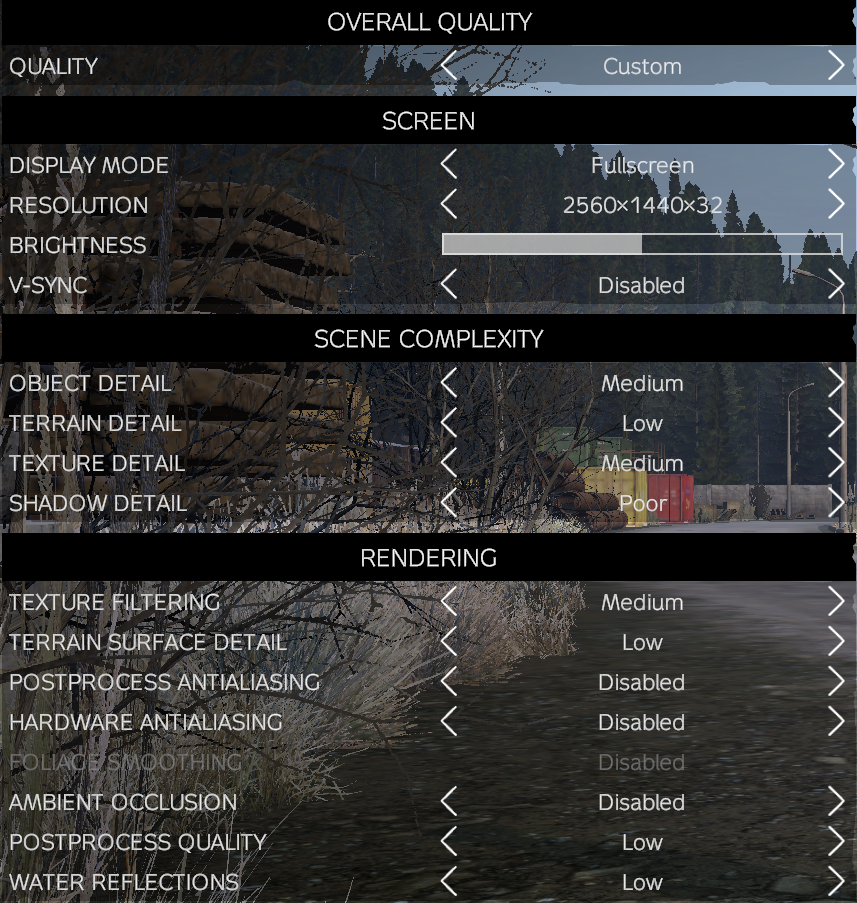

for the settings if you need to recreate the issue, first set overall to high as this controls draw distance then make changes to the other settings. Just dayz things I guess lol. i would also recommending running to a big city to see how bad it stutters. runs like a charm outside of bigger cities but its a slide show in the cities. It may not be a gpu issue but my knowledge kinda ends with everything I've tried.
Jonnybads
8,482 Views
here's the ssu

We have been working on the investigation and we were able to reproduce it by testing different driver versions including version 31.0.101.4900.
Yesterday we released a new version 31.0.101.4952. Please clean install it with DDU, to check if there are improvements, if you still need guidance, remember you can use How to Use the Display Driver Uninstaller (DDU) to Uninstall an Intel® Graphics Driver.
Let me know the results.
Andres P.
Jonnybads
7,925 Views
I installed the new driver and everything runs great now. The cities dont stutter like crazy anymore and the vram issue seems to be resolved. thank you so much
