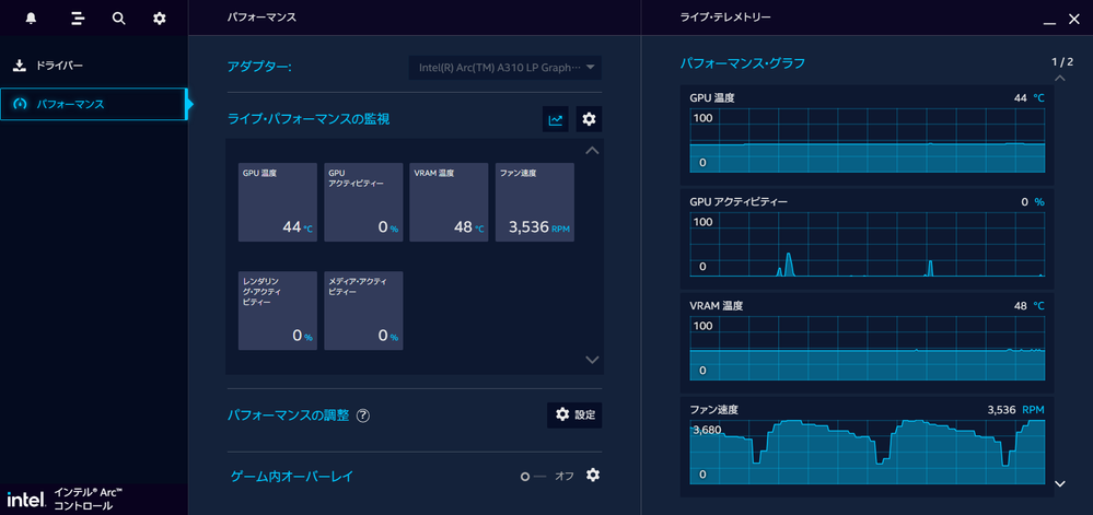

My Sparkle Intel Arc A310 ECO's firmware was updated when I updated the driver, but nothing improved the poor fan controls. It keeps repeating 0-3000🤬

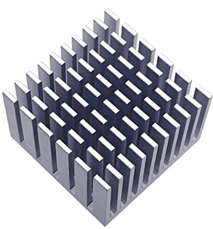

I stop this poor fan, install a heat sink, and use a 140mm fan to blow air from the side.

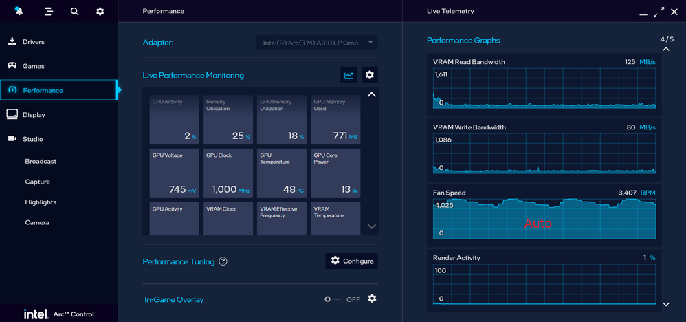

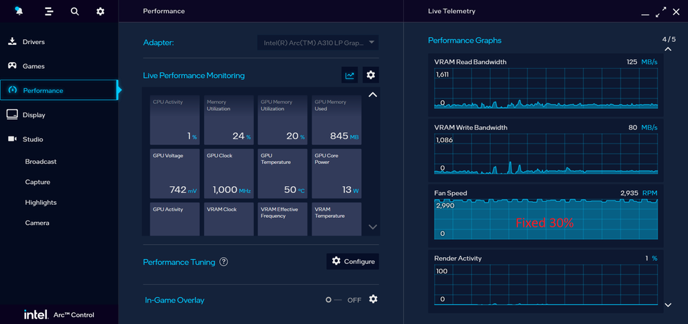

I have set the fan control to automatic and will upload a screenshot of the performance graph in Intel Arc Control during AV1 encoding.
However, please note that this longer interval of 0-3000 RPM repeating is due to additional cooling provided by an extra heatsink and fan.
Without additional cooling, the 0-3000 RPM intervals would be shorter.

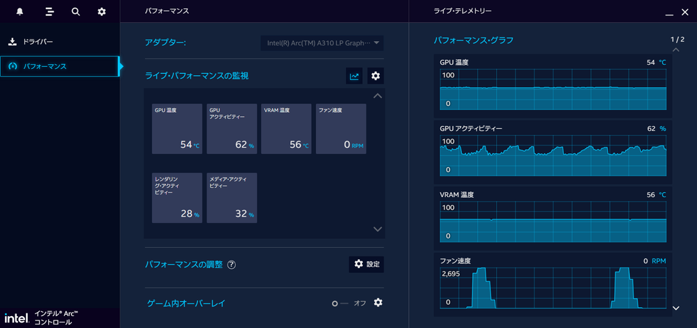

I use a custom fan curve to set the fan to 0%,
install multiple heat sinks used for general FPGAs and ICs and use additional fans for cooling.
With this cooling, the GPU temperature seems to be stable at around 54℃.
(This is because the original fan starts when the GPU temperature exceeds the fan curve setting)

It seems like Intel developers still don't understand what the problem is, so I've prepared some additional information.

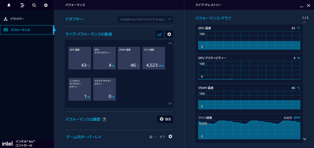

This is the performance graph when the fan control is set to target 100%.
And this is the link to the file that recorded the fan sound in 100% case
https://drive.google.com/file/d/1S-JcXxc9uoJDtJ5G324mwPnqAOr8Mr4c/view?usp=sharing
This is a performance graph when the fan control is set to auto.
And this is the link to the file that recorded the fan sound in case of auto
https://drive.google.com/file/d/1RyKkaSRsx19s60BESDsFcaa7JBUAH8dY/view?usp=sharing
And this is a graph that shows the fan speed at idle that we users want.
(red line)

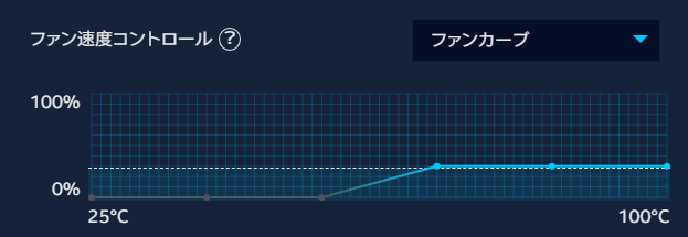

I have set the fan curve as below to stop this very noisy fan.
And I installed an additional heat sink and fan to control the temperature to around 55℃ even while QSV AV1 encoding.
There is no need to talk about the undesirability of 55℃.
The case has enough airflow to ensure that the temperature inside the case does not rise
Why does the fan speed keep going up and down?
I've been working with computers since before MS-DOS, but I don't know of any video card other than the Intel Arc that makes the fans so noisy even when the temperature is constant.
Is this product an industrial grade product?
It shouldn't be.
Temperature is definitely a priority for automatic control, but noise should be a priority as well.
