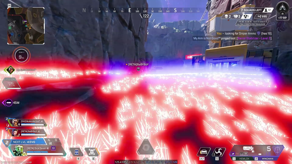

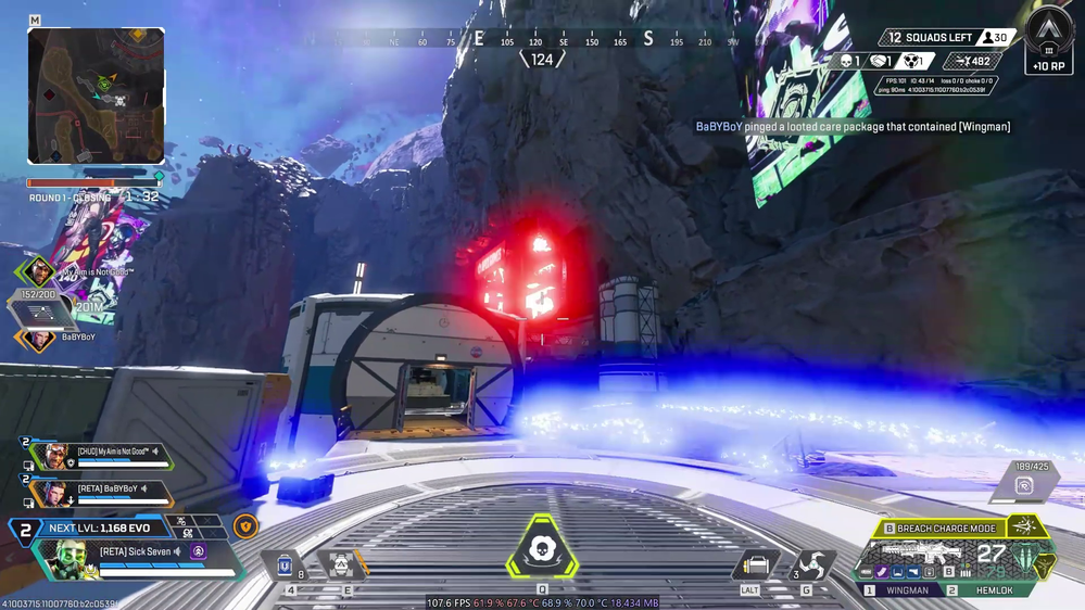

did you get any fixes because it got even worse in the new ranked broken moon map. cant see anything but flashing bright red and blue lights. yes i tried reinstalling the drivers, and even the game. did full clean shader cache files, also tried with any sort of overlay on and off still no luck. been having this issue since last few season but it was minimal but now its literally unplayable on this ranked map vlcsnap-2026-05-06-03h58m52s895.pngvlcsnap-2026-05-06-03h59m58s936.png
