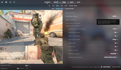

cs2 crashes.  game just closes no error.  5333 driver.  same happens for valorant.  driver 5194 no crashes
1440p 
