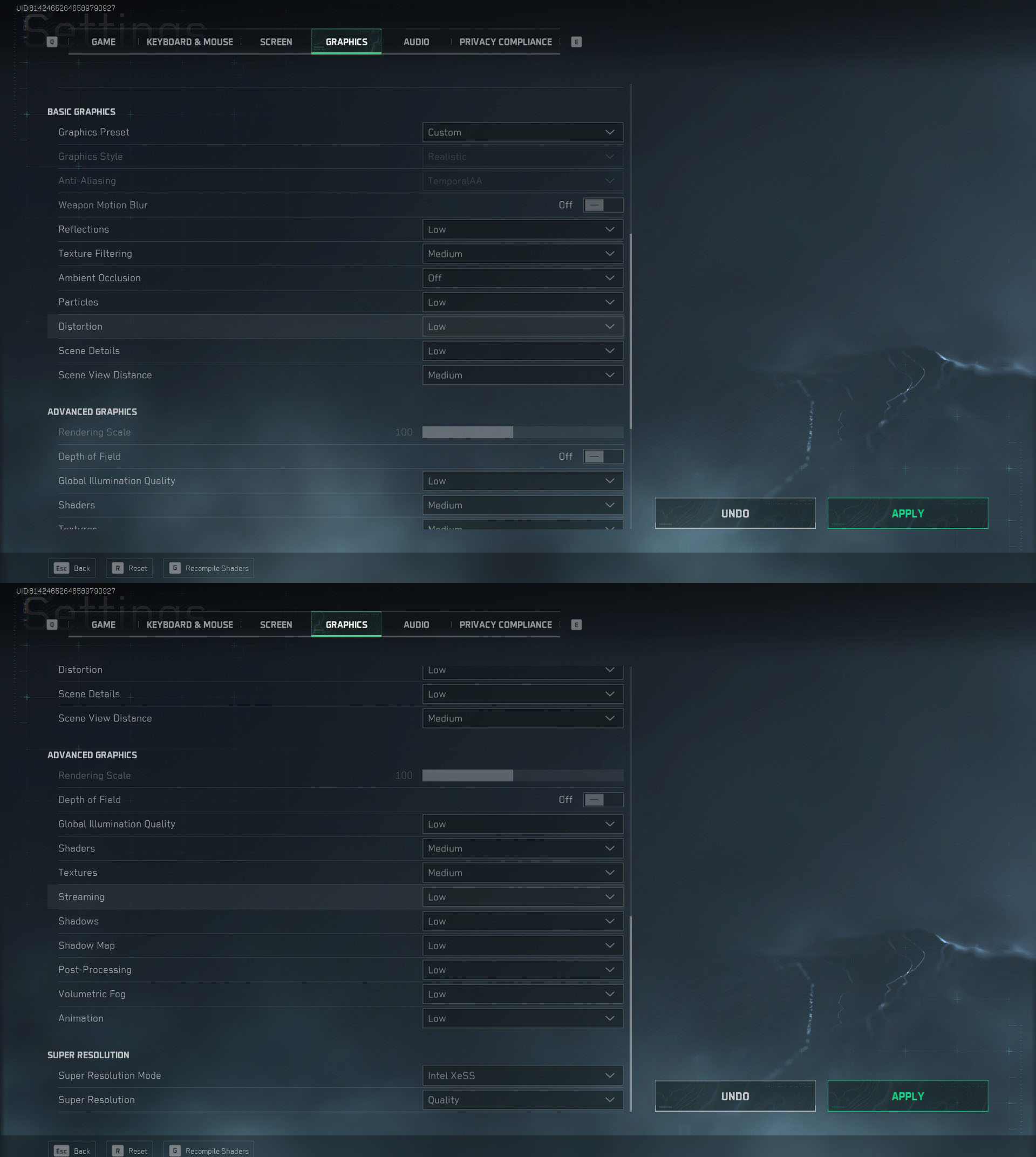

my arc a580 driver is 32.0.101.6319.In delta force i am getting around 15-17 fps and audio is bad too.
i also tried WQHL certified 32.0.101.6314 ,both has same problem.
i noticed that my gpu only consume 40w while playing delta force,other games do'nt have this problem.
my cpu is rayzen 7600,re-bar enabled.

  3. Can you show me your game settings?

  3. Can you show me your game settings? Everything is set to LOW and with XeSS upscaler set to Balanced. Running at 3440x1440 @ 144Hz
  =all low setting

Thanks for sharing this with me. You mentioned that your settings in Delta Force are all set to low. I want to ensure that when I test this on my end, I can use the same settings to accurately replicate the issue. Could you please share a screenshot of your in-game graphics settings?

GoldPlay
55,018 Views
Hi Dhanniel M.
 Thanks for waiting.I shared my display info in attachment.
 According to your suggestion,i updated my driver 32.0.101.6458/32.0.101.6256 and after changing my setting ,recompile shader but there is no change in game performance and fps.
I also updated my driver32.0.101.6458/32.0.101.6257 (WHQL Certified)  using clean install option.
Additionally, i created 2 custom profile after @Zerphire  posted but there is no change.
Updating my Delta Force 81GB using steam,i hope this update fix the problem.
