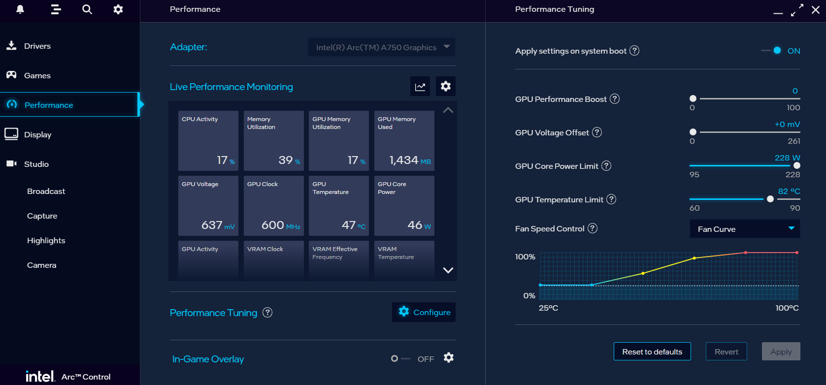

I switched from 1060 6GB to A750, used DDU, and did Windows 11 clean install multiple times currently running 24h2. I tested valorant, cs2, pubg, black squad and spectre divide. in all the games I have seen sudden fps drops and once it drops, it hardly recovers. in black squad, I am facing screen flickering and made it unplayable. in most of the cases I found my 1060 provides me much better and more consistent fps than the a750. i giving me sudden lags and sometime screen freeze and in sometime it seems there are input latency issues. if anyone have any solution like any special settings or 3rd party tools that can help as I did all windows performance optimizations but it seems the same. i tried installing environment for ollama on ubuntu 24.04 and there I'm not getting proper resources to utilize this. only think it can does decent is av1 encoding 3 times faster than my CPU. if I got get any fixes or guides soon I will switch to nvidia again as its like plug and play for me.

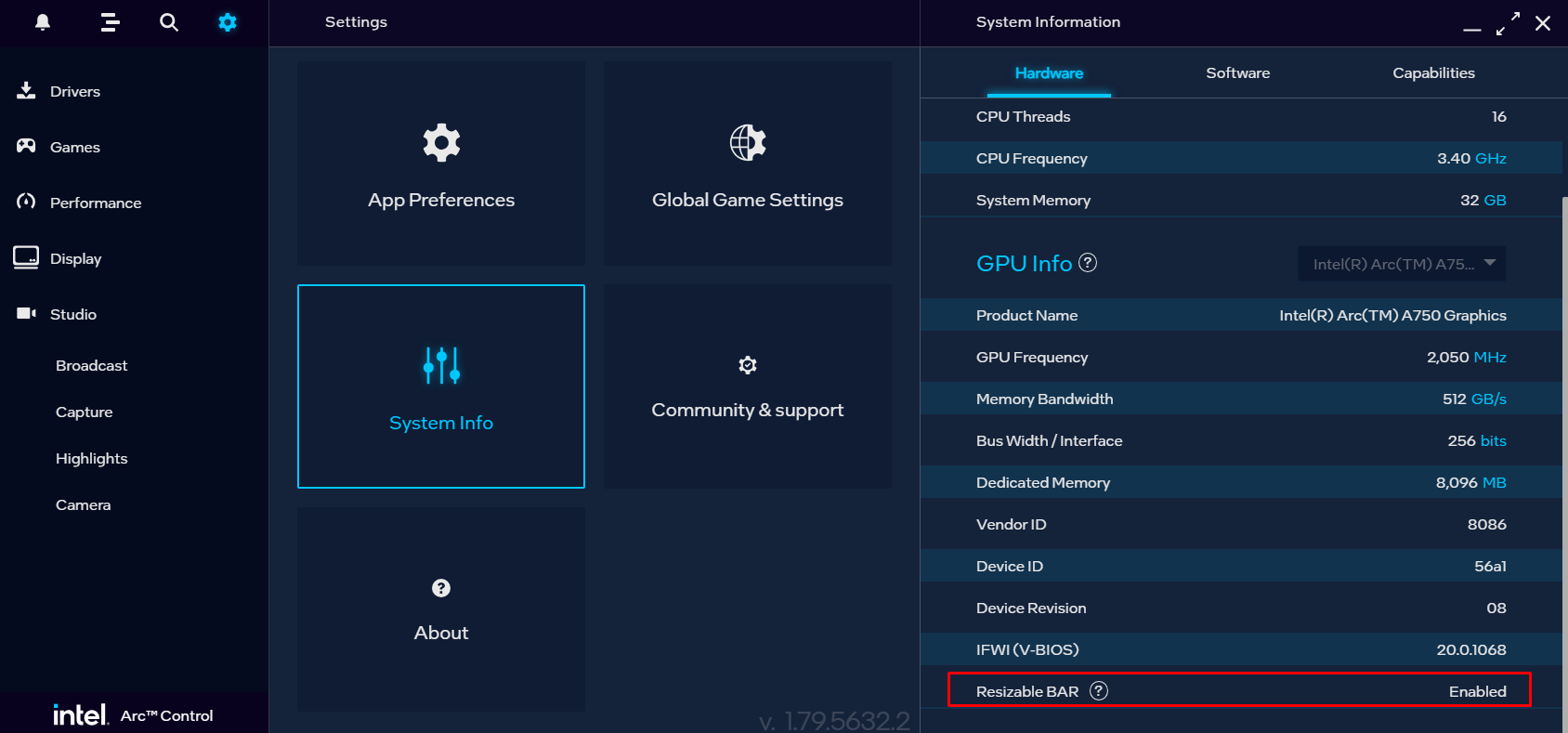

I would like to know more about your system details to fully understand where the issue truly lies. Please help provide the actual system device (MSI X370) that you have. What are the currently installed BIOS firmware and graphics drivers? Additionally, we highly appreciate you sharing your system configuration so we can fully check and provide you with an accurate fix. This could be possible by downloading the Intel® System Support Utility for Windows* software. When the download is complete, launch SSU.exe.

1) Check and confirm that the Resizable BAR or Smart Access Memory is enabled for optimal performance in all applications.

Dear Jeanette,
I have followed most of the top yt tutorials for maximizing performance but still, it's not fixing these issues. I have added the files as you asked. There are some difficulties with obs settings with arc so I will provide videos later. You will have some context if you go through the CapFrameX files and my narrative.
