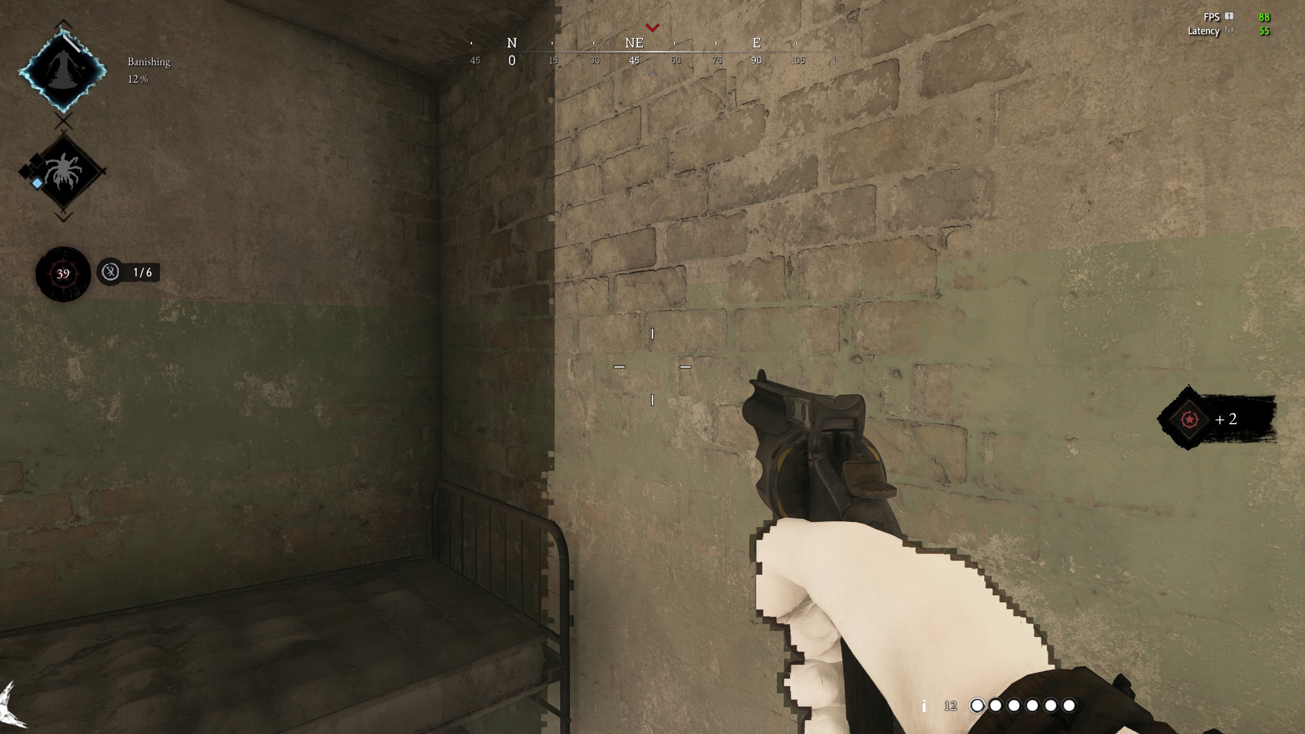

Hello
I have been in contact with the support team from Crytek about this and apparently they do not do any testing on Arc cards nor do they have any plans to implement XeSS, perhaps you should get in touch with them about that.
The issues that occur is according to them(after sending them logs) a driver restart, the game freezes for a split second and then the fps ramps up again from seemingly zero. This happens very often and only in this game as far as I'm aware.
Another issue us that textures on models sometimes don't seem to load in properly, but it's not the whole model but depends on the viewing angle, possibly a lighting issue?
I'm sending a few screenshots of the issue.

Hi @HappySalmon,
  • When did the issue first occur?
  • Have you made any software or hardware changes to the system recently?
  • Have you noticed any signs of overheating in the system?
  • Which digital distribution platform did you obtain the game that is experiencing graphics issues? (e.g., Steam, Epic Games Store, GOG, etc.)
  • Have you previously performed a clean installation of the graphics driver, before using either an older or the latest version?
  • Kindly share some screenshots and recordings of your game settings so we can replicate and check the issue on our end using the same settings you use during gameplay.
  • Additionally, you may follow this guide on how to report performance issues in the game.

Hello Randy
I don't remember when I didn't have this issue.
No changes have been made to the system.
No overheating.
Steam.
Since I am running a B580 and an A770 before that, I of course always perform clean driver installations, often with DDU.

I just want to say that I have exactly the same issue as the OP. Exactly the same graphical artifacts, and the same performance issues. I've reported a shader cache related issue here on the forum, so there is definiately a compatibility issue between the game's engine and the Arc drivers.
With respect, I would like to tell you that running CapFrameX or the SSU log wont help to solve this issue. These graphical artifacts only happen with Arc cards, since the game's engine CryEngine is not supporting these cards properly. Its not your fault, its Crytek's absolutely unaccaptable fault, since before their last year's engine update, the game supported Arc cards totally. Even had XeSS.
I would like to ask you to please just move close to a horse in the game, or even dogs or the place's where these textures exist, and you will immediately see the issue.
