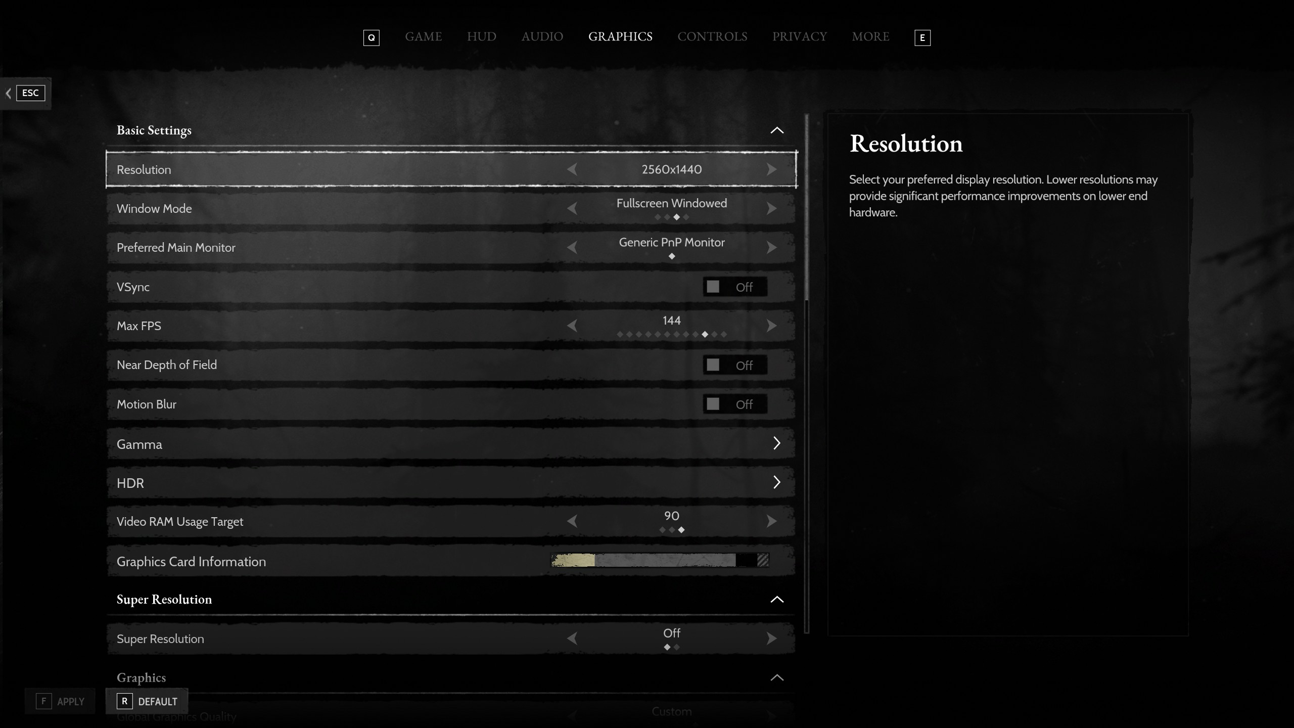

envisioning
9,070 Views
As mentioned in the original post, this issue does not change no matter which video settings you use. Attached is a screenshot of the settings, but it really does not matter which setting you use (as I have tried modifying everything).
As for the surfaces, it is just about everything that can cast a shadow, it seems. If you just go to the single play practice, and look around, you will immediately see surfaces with shadows (trees, foliage, walls) flickering near and far.
