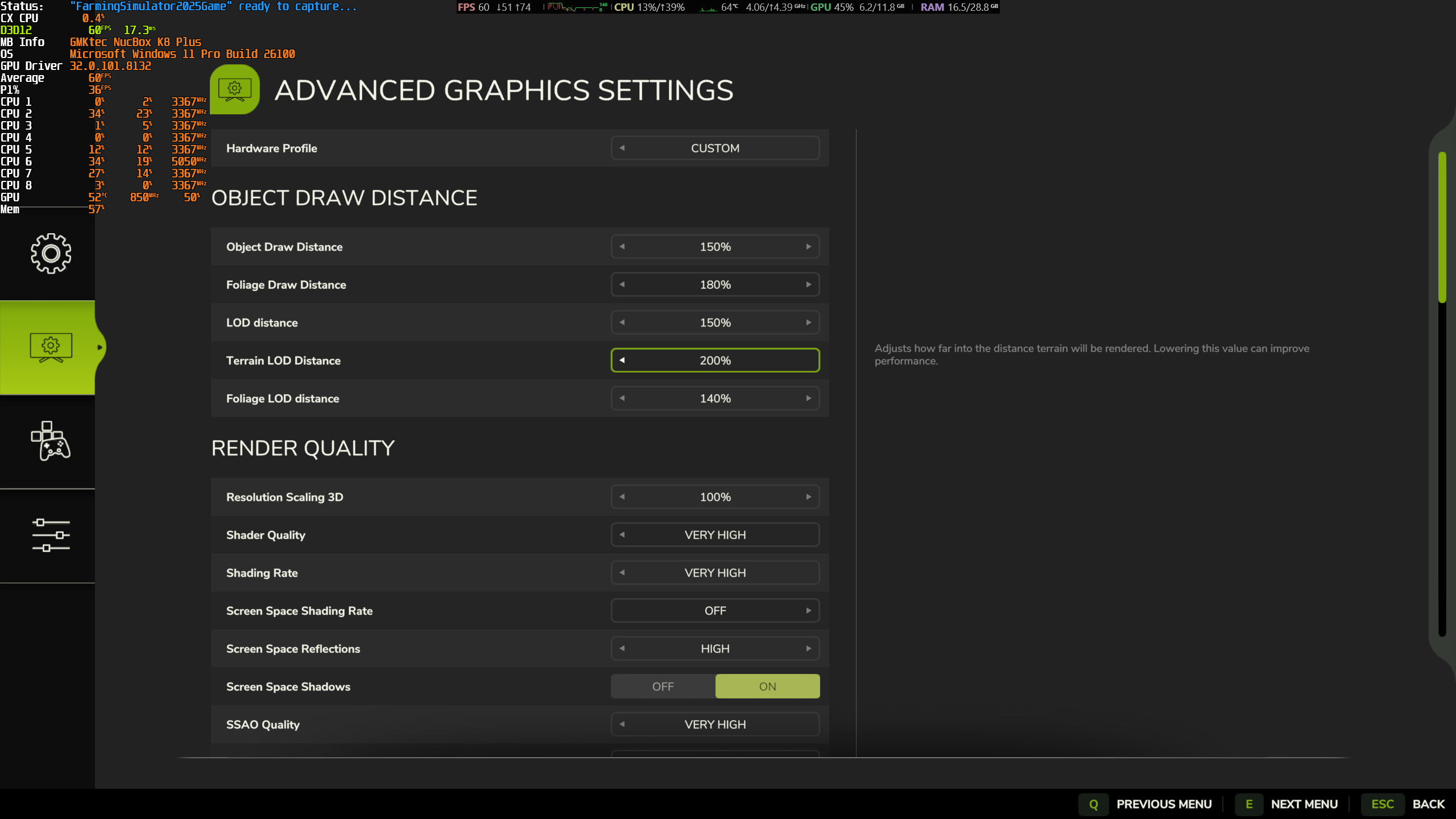

crashes everytime i try to change graphics settings with XeSS 2 frame generation

yes i get the cpu fallback instead of gpu decompression when XeSS 2 frame generation is enable when trying to change settings

Hi Scarface1,
Thank you for providing the Windows Event Log information. I can see that the crash is occurring in the Steam overlay renderer (gameoverlayrenderer64.dll) when trying to use XeSS 2 Frame Generation in Farming Simulator 25 with your Intel Arc B580 eGPU setup.
I understand how frustrating this must be, especially since you've already performed multiple DDU clean installations and the DirectStorage is falling back to CPU decompression instead of utilizing your GPU's capabilities.
The Event Log shows an access violation (Exception code: 0xc0000005) in the Steam overlay, but to get a more detailed analysis of what's causing the crash, we'll need the actual crash dump file rather than just the Event Log entry.

steam overlay is indeed the issue. I disabled steam overlay and I'm able to change the settings with XeSS 2 frame generation on.
also with XeSS 2 frame generation turned on, i'm still getting 60 fps as i would without it enabled. i should be getting over 100+ fps like i do with FSR 3 x2 enabled

Excellent detective work! Thank you for confirming that disabling the Steam overlay resolved the XeSS 2 Frame Generation crash issue. This confirms that the problem was specifically related to the interaction between Steam's overlay renderer and XeSS 2 in your eGPU configuration.
You've successfully isolated the crash cause to the Steam overlay, which is valuable information for addressing this compatibility issue.
XeSS 2 Frame Generation Performance Concern: I also note your observation that XeSS 2 Frame Generation is only providing 60 FPS instead of the 100+ FPS performance boost you're getting with FSR 3 x2. This suggests there may be an optimization issue with XeSS 2's frame generation efficiency in your specific eGPU setup.
