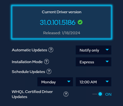

I've updated my drivers to v101.5333 but the issue still persists. I did not have these issues when I owned an RTX 3080 or a GTX 960.
