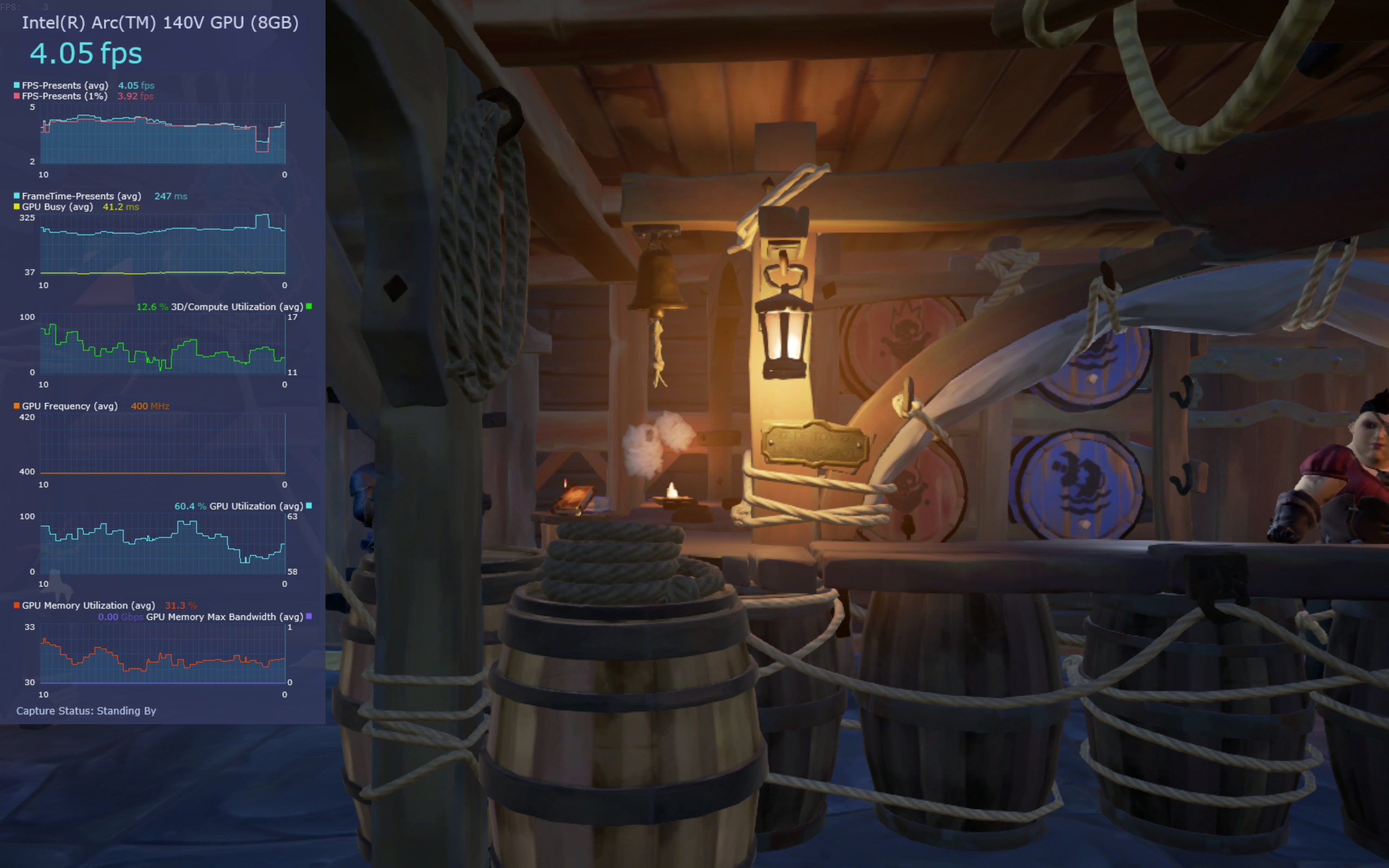

I have a Dell 14 Plus with Arc 140v.  I've previously played Sea of Thieves without issue.  Recently, when I attempted to play, the framerate would start out at 30-50 fps and near 100% 3D/Compute utilization, and then after a minute or two, would SUDDENLY drop down to 4 fps and 10-15% 3D/Compute utilization.  It reminded me of a thermal throttling situation, but I don't think that's what it is because the CPU temp was always around 72c-74c.  Every once in a while, it would pop back up to 30-50 fps for a number of seconds, then back down to 4 fps again.  It didn't seem to matter what I was doing in the game - most of my testing occurred staring at the same wall.
I clean installed the latest drivers - 32.0.101.8132
I do not have the option in the BIOS to enable reBAR.  As I understand it, Dell only has that option available for certain models, and it does not include the Dell 14 Plus.  But again, the computer definitely has the capability to play at a higher FPS, just seems that something is limiting it.
I tried playing Dyson Sphere Program for a while and it works flawlessly despite near 100% usage of both GPU and CPU (Sea of Thieves isn't as CPU-heavy).  It seems specifically related to Sea of Thieves and not the system as a whole.
I've attached screenshots of the game graphical settings (basically everything set to the lowest and resolution at 720p).  I've also attached a couple of screenshots showing trends of performance where you can see the drop in FPS/utilization.  I've attached the SSU as well.
Please let me know what else is needed from me..!

I've attached the CapFrameX logs.  It started off strong, 45+ fps, then after just a few seconds after the capture started, went to 4 fps and stayed there the whole time as far as I could tell.  Sorry, I didn't catch the exact timestamp for the change but it did not take long.

Thank you for providing the CapFrameX logs. I can see from your description that the performance drop occurred very quickly after capture started - going from 45+ fps down to 4 fps and remaining there throughout the recording session. This rapid and sustained performance degradation pattern is very telling for our analysis.
Your detailed documentation, including the SSU report, performance screenshots, and now the CapFrameX data, provides us with comprehensive information about this Sea of Thieves-specific issue with your Intel Arc 140V.
I will be investigating this matter internally and will get back to you with an update once I have more information available from our internal investigation.

Thank you for providing the comprehensive performance data and testing results regarding the severe performance degradation you're experiencing in Sea of Thieves on your Dell 14 Plus with Intel Arc 140V graphics.
Issue Analysis: I've reviewed your detailed documentation showing the dramatic performance drop from 45+ fps to 4 fps within seconds, along with the corresponding GPU utilization decrease from ~100% to 10-15%. Your comparative testing confirming that other demanding games like Dyson Sphere Program work flawlessly helps isolate this as a Sea of Thieves-specific compatibility issue.
Current Investigation Findings: After analyzing your SSU report, I've identified that you're currently using the Intel Generic graphics driver. This may be contributing to the game-specific performance issues you're experiencing.
Recommended Solution - OEM Driver Testing: To isolate and potentially resolve this issue, I need you to test with the Dell OEM-specific driver version:

I have installed the OEM drivers as shown in the attached screenshot.  Unfortunately, the behavior remains the same.  The game started off at 45 fps and dropped to 4 after 10-20 seconds.
I forgot to mention in my original post that part of my initial troubleshooting involved installing the latest Intel drivers, and I'm not sure what Dell drivers I started with, but regardless, both/all drivers have the same issue.
