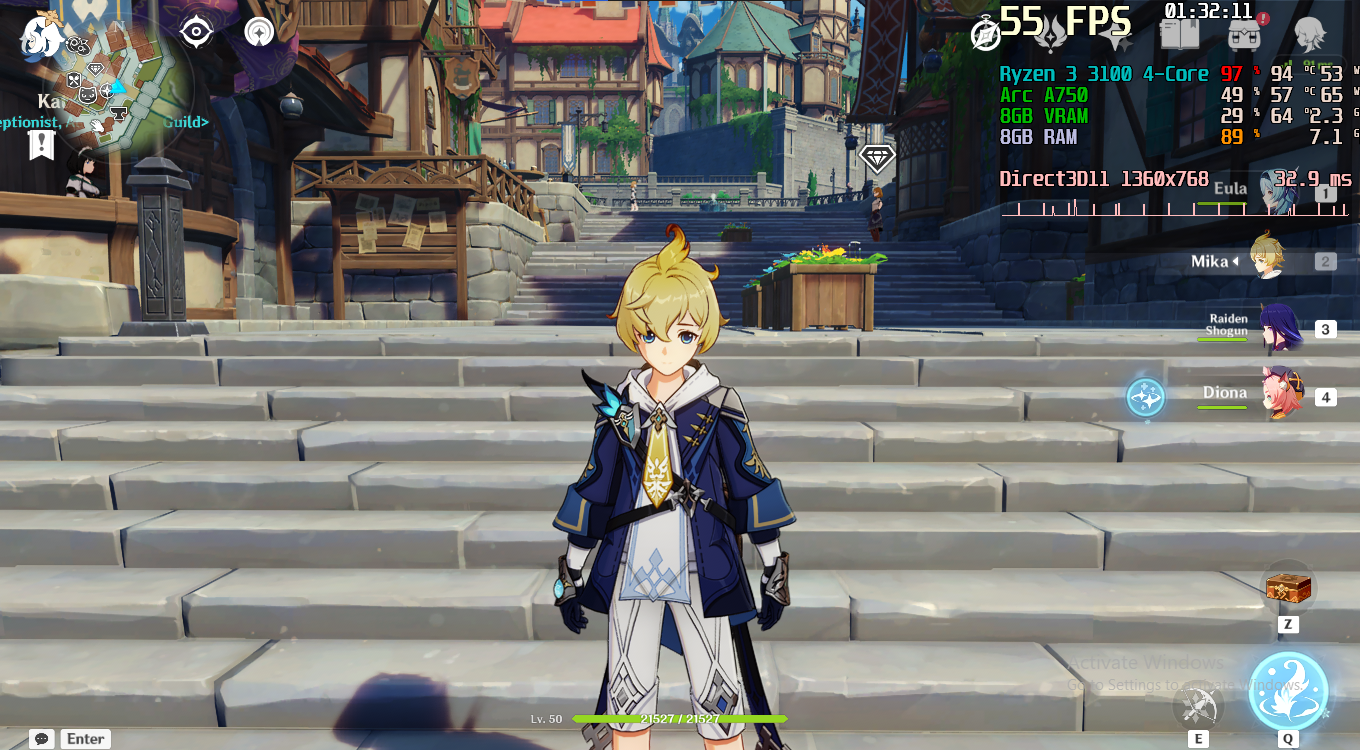

Hello, I have bought the Intel Arc A750 2 days ago and the GPU arrived today. I chose to trust Intel again because it looked promisingly competitive in the GPU market and I searched high and low for possible problem for my pc, at best what I could find was simply the bottleneck of my CPU itself and the PCIE 3.0 x16 motherboard, but I wasn't that much expecting to get into the best games right away and I had plans for an upgrade in the future, maybe in a year or two.

However, the actual performance wasn't looking great, the CPU utilization in my AMD CPU is about twice as high on normal use. I had a GT 1030 prior to this so I know, and for reference I tried it on the most basic game that still exist and is popular which is Roblox, there were noticeable spikes in CPU latency and the utilization of the CPU is about twice compared to when I had the GT 1030 on. I had my expectations low after that and tried it on the least demanding modern game I know of, Genshin Impact (apologies for the low standards, this game is the best game my pc could handle well at the time). The result was awful, the game was unplayable, constant freezes everywhere, any sudden moves and you will get that. It takes from 5-10 seconds until the freeze stops and the loading times are about nearly 2 minutes. The CPU usage was in an awful 87-100%, and it resulted in a lot of freezes. The RAM usage was about 84% from the previous GPU but now it's all the way to 98%.
I honestly do not think it can be blamed to the other parts as this was never an issue with the previous GPU. I have plans to add another 16GB of RAM and NVMe storage but please! Try to fix the CPU usage overall or at least towards the Ryzen 3 3100, it's making me almost cry and it's awful. You can do better than that Intel. Is there any temporary or neat solution to this? Or how long would I have to wait for this fix to come?

Here's an update so far, after using the GT 1030 for a bit again, I decided to swap back to ARC A750 to check on the performance of the GPU.
1. So far the CPU utilization has subsided while on idle. Before it was at least 10%-20% but is now 5%-12%
2. I've tested it on the other games (Max Graphics NFS ProStreet [dx9] and Honkai: Star Rail [dx11]), they all showed good results (60 fps) with stable CPU utilization around 40%-50% unlike at the time I posted. I'm going to test it towards the other games (Hearts of Iron IV, Sniper Elite 4, Left 4 Dead 2).
I have disabled the XMP however I do not have integrated graphics and used the previous GPU instead, it did not have the spikes. The same goes for the previous GPU with XMP on with no spikes or stutters.
The only games that I am sure that has higher CPU utilization is Roblox (lower frames in slightly CPU intensive map compared to GT 1030) and Genshin Impact (Awful 95-100% CPU utilization)
I thought about what happened last time why it performed bad in other games and I concluded that I had my CPU utilization up in Genshin Impact for a long time that it hit an alarming 100C temperature resulting in thermal throttling of the CPU. It performed as bad in the other games (NFS Prostreet and Honkai: Star Rail) after testing it in Genshin Impact for at least 30 minutes because of the thermal throttling. So now you know how bad the GPU did to my CPU. My Ryzen CPU is still using the stock cooler.
May I know how XMP profile affect the GPU? Thanks.
I have also installed Intel Computing Improvement Program. Hopefully the next driver improvement includes more fix for my CPU although I won't be touching Genshin Impact for a while using Intel Arc because it badly made my CPU overheat.
I hope the screenshots will provide more description

Let me tell you that after a lab where we tested Genshin Impact, we were unable to reproduce the issue.
We setup a system with Ryzen 5 3600 + 16GB of RAM and with A750 the CPU usage was consistently low when playing Genshin Impact and FPS consistently above 55 FPS even on crowded areas (refer to Frametime and FPS data attached)
Video of our lab uploaded here: https://youtu.be/OgvXQt99t8U
In this case, we suggest performing a clean OS installation just to rule out OS conflicts but otherwise think about adding more RAM as 8GB is the minimum recommended by the dev:
https://genshin.hoyoverse.com/en/news/detail/103699
Isaac Q.
