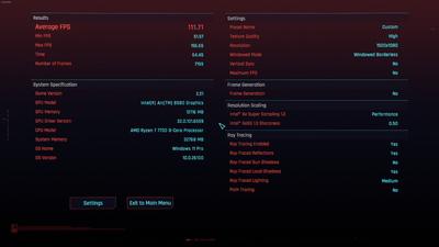

On a brand-new Windows 11 system with clean driver installations, I'm experiencing significant FPS variance in the Cyberpunk 2077 benchmark.
Running the same benchmark repeatedly with identical settings results in average FPS ranging from 40 to 69.
  • Behavior:
    • The first benchmark run after a system restart typically yields the highest FPS.
    • Subsequent runs show a gradual decrease in performance.
    • No other applications are running during these tests.
  • System: New PC build, fresh Windows 11 install, latest Intel Arc drivers.
  • Attached:
    • ISSU report.
    • Screenshots of benchmark results (including overclocked and standard settings).
  • Note: While I do overclocking, the issue persists using standard overclocked card settings, as shown in the provided screenshots. The issue persists with non overclocked settings as well.
  • Driver Version: 32.0.101.6734
Please investigate this significant performance inconsistency.

I have done some additional benchmarks with two older versions of drivers. The screenshots are attached with all versions in the screenshots. these were done with standard/ default clocks; no overclocking.

Questions answered below:
I used steam.
I disabled the steam overlay but the result was the same.
This is a brand new build no other card was used before. The ryzen 7 7700 comes with on board graphics, however I disabled it in bios. The problem started from the beginning.
Even minecraft was doing 30fps average. Surprisingly the games I ran didnt do good performance.
Stray is another game I ran that roughly did 40fps on high settings that is one step down from the max settings.
I ddud (ddu driver display utility) the drivers and did a clean install of both the latest drivers and cyberpunk again, without any change in fps numbers.
